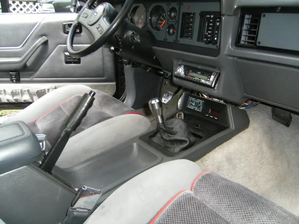

    A custom titanium one I made years ago. You can see it in this pic. I don't remember the dimensions, but it's not big.
