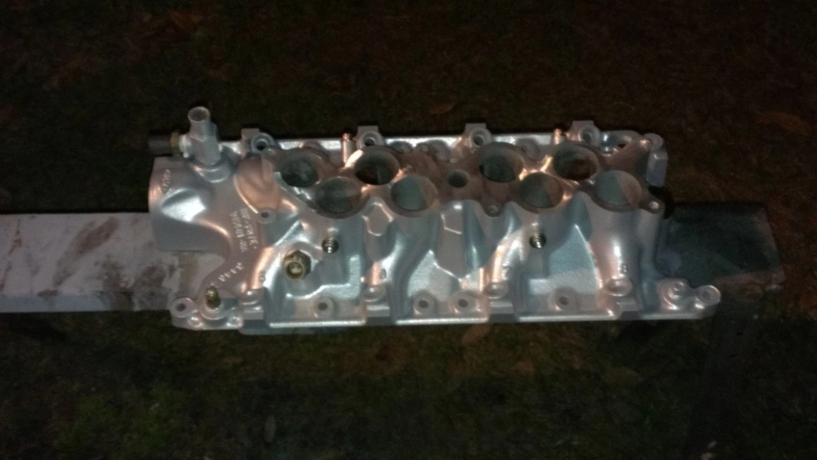

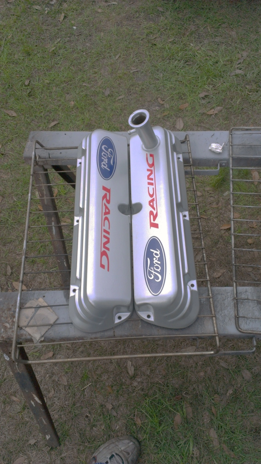

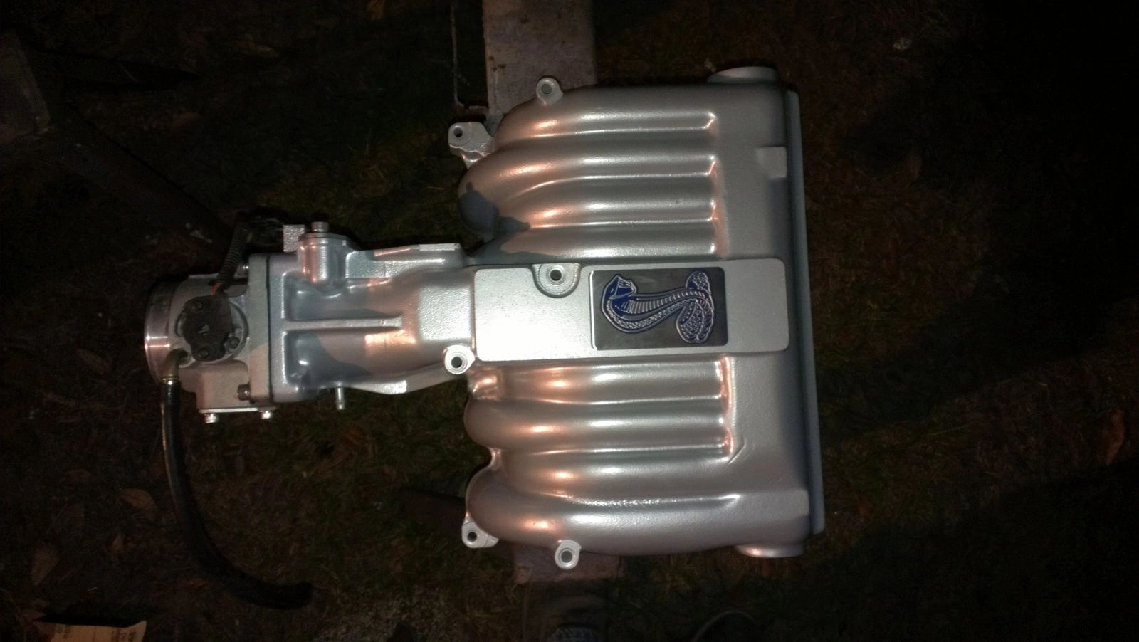

  1. I cant decide what color to bake the lower intake on my fresh 306. right now im using flat black and anodized silver. should i bake both intake and plenum silver or do the intake black and plenum silver...........

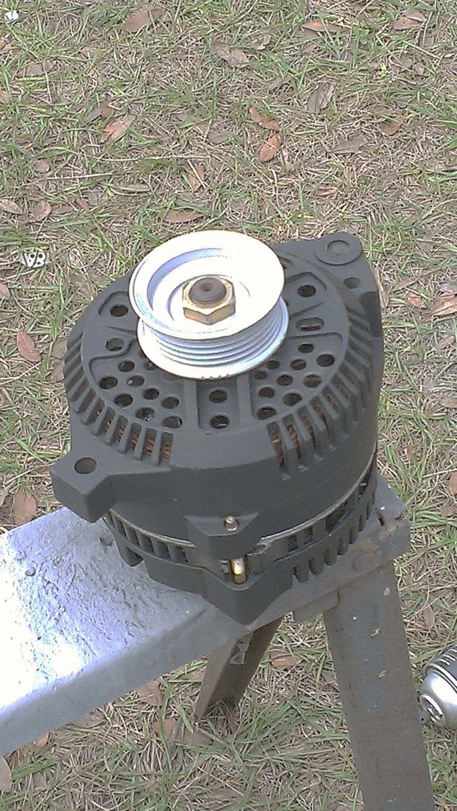

    The valve covers and pulleys are silver, i did the alt and timing cover black. Some high temp stickers finished off the valve covers. IMAG0218.jpg IMAG0220.jpg IMAG0221.jpg
  2. Im no fan of flat black so i say go silver
  3. Im not sure how to PC but why don't you combine the 2 like a base color and then accent it with the second color

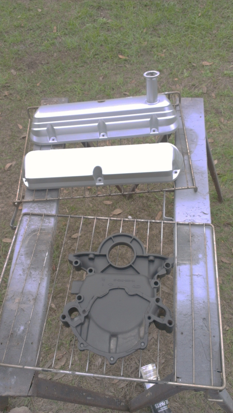

  4. really hard to do well for me it is.anyway here is how they turned out. IMAG0020.jpg IMAG0224.jpg
  5. They turned out good. I'm gonna have to learn how to do powder coating.
  6. really easy i use a old oven off the side of the road. then got a wai powder gun off ebay. and a elcheapo sandblaster. 150$ total with powder. no compressor required.
  7. how long does it usually take to bake?
  8. 20-30 mins.
  9. Wow, turned out great! Is it really this easy and inexpensive to do? I never would have guessed.
  10. well i got the oven for free. the wai poder gun is a summit brand on ebay they run $60. then i got a harbor frieght sand blaster, kettle style. powder from eastwood on ebay. oh and a couple cans of brake clean non-clorinated to rinse the parts. not ideal but cheap and the outcome was great. ill never paint another engine part. next im gonna use chrome then a translucent black clear, should look killer

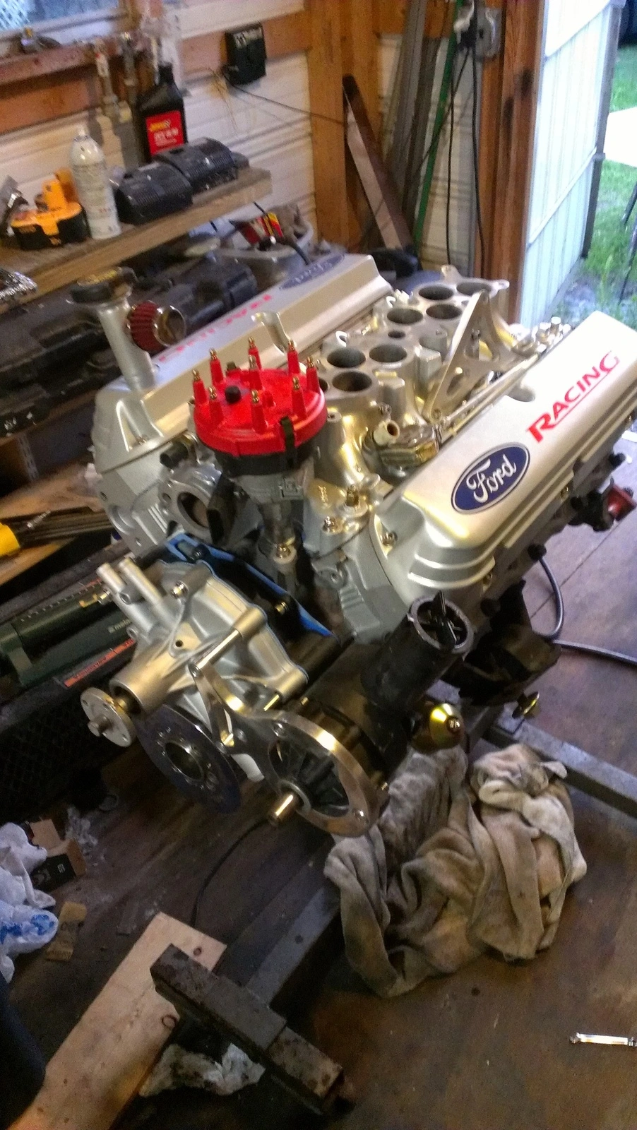

  11. ok got her together all new balanced guts. tryin to figure out some front dress fitment issues now. pretty happy with the way it looks. IMAG0234.jpg
  12. Wow that looks good!! To bad you cant do something with the power steering pump.
  13. thinking about trying a remote reservoir pump off a newer car. from what ive read it should bolt right up.

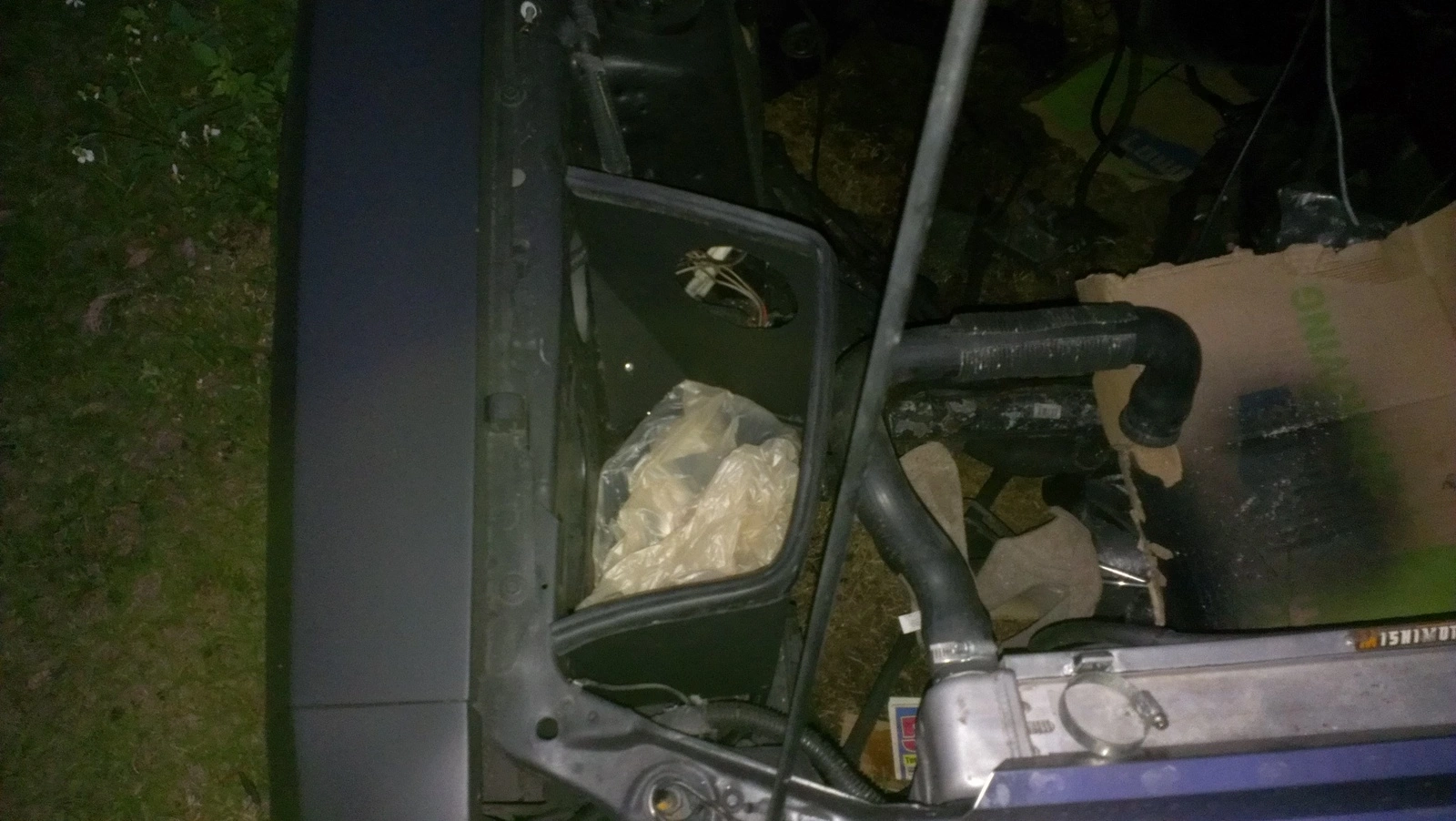

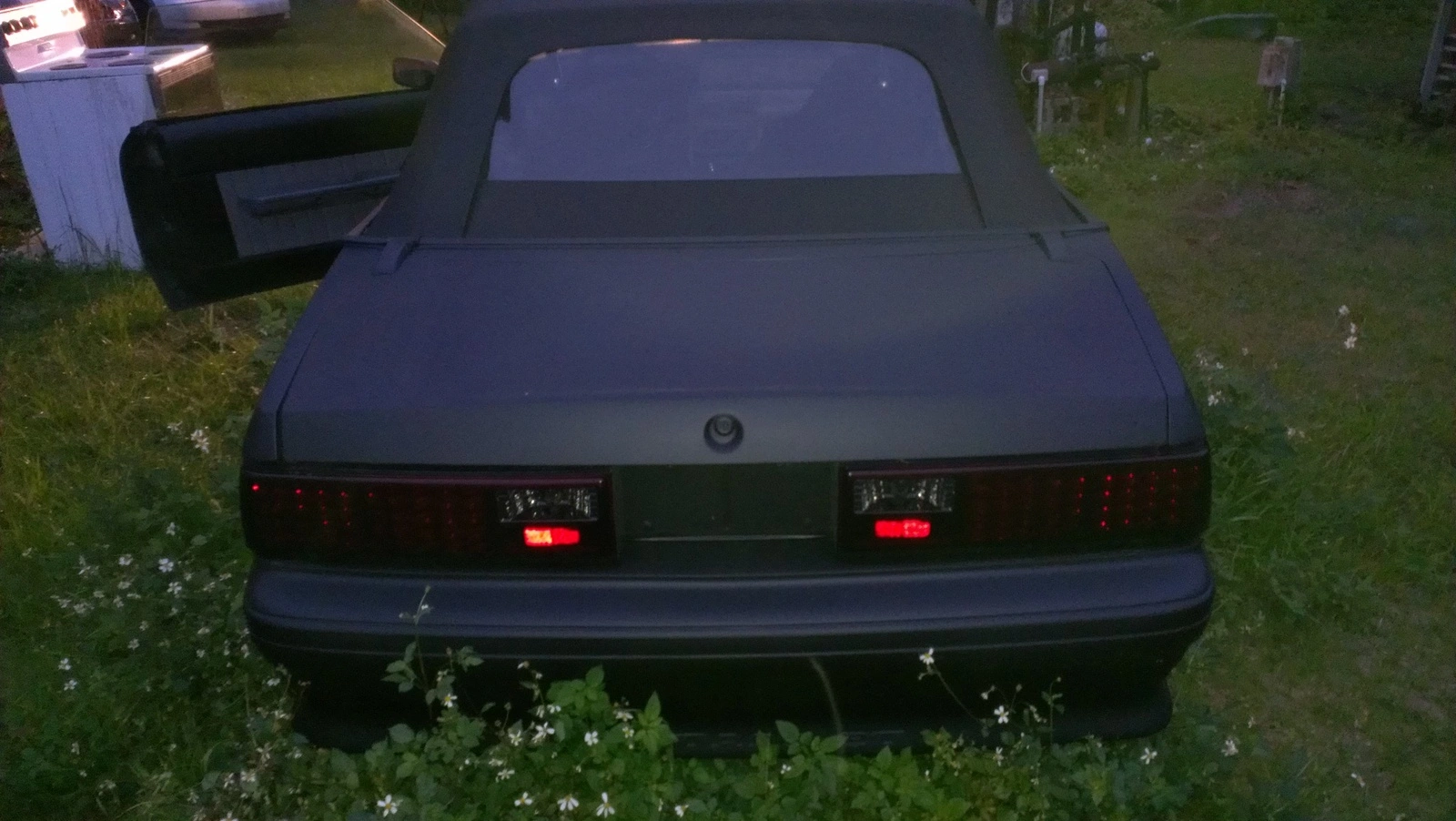

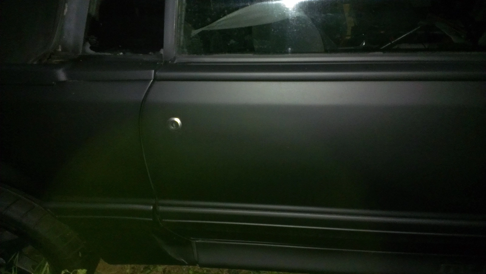

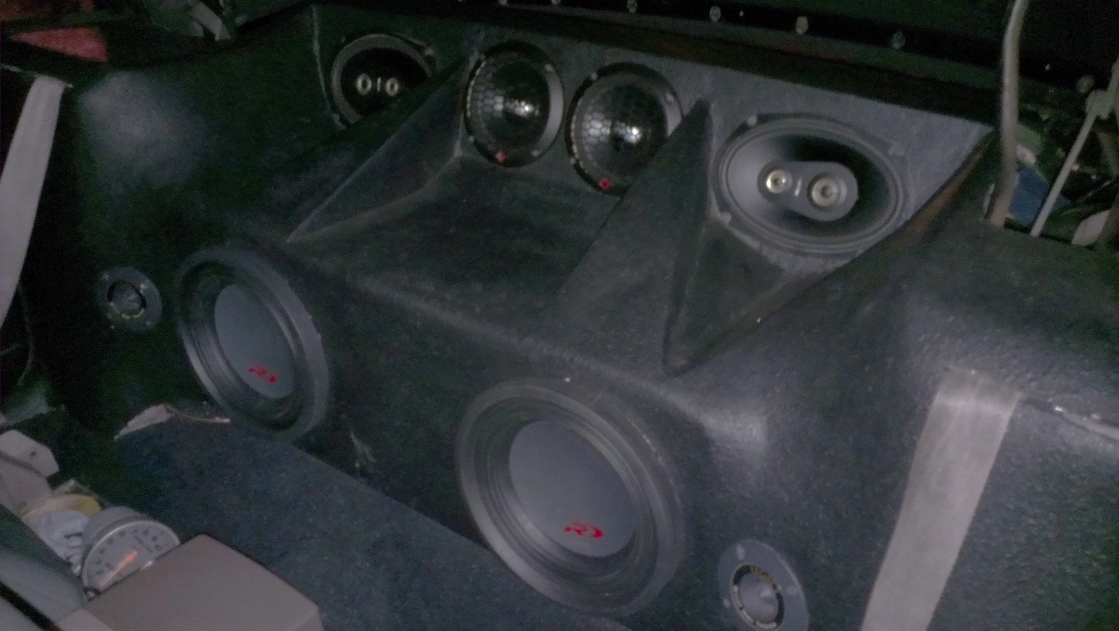

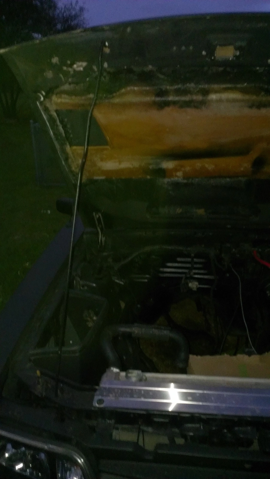

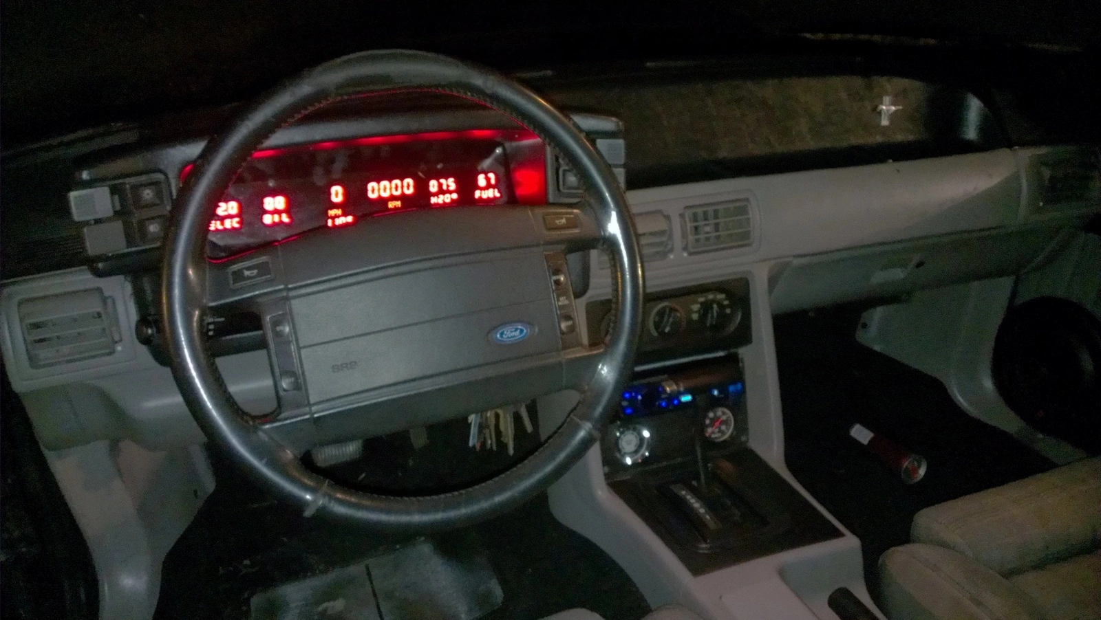

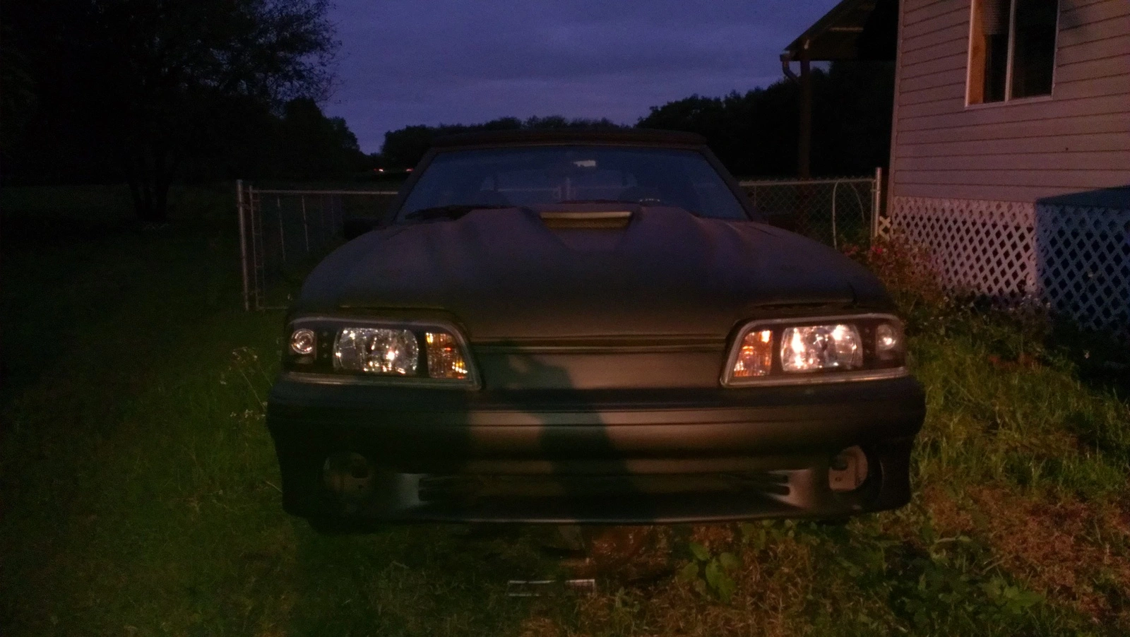

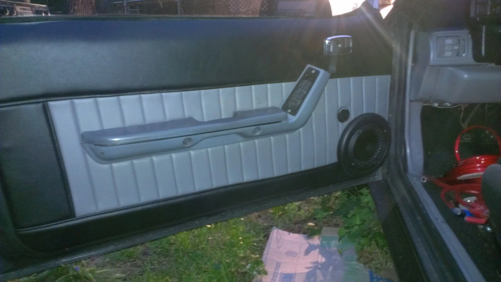

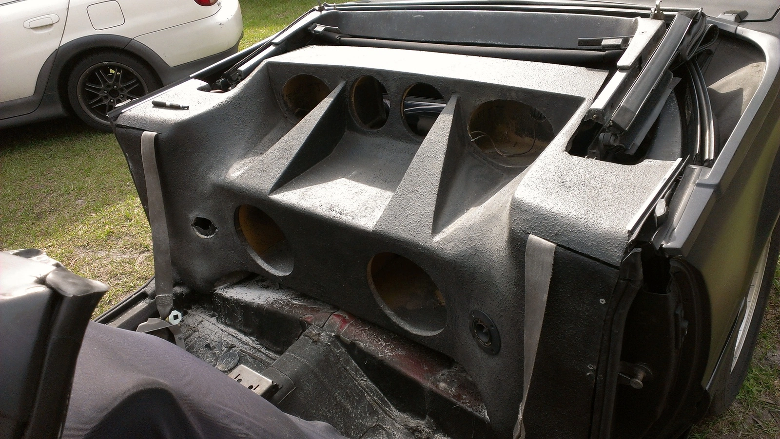

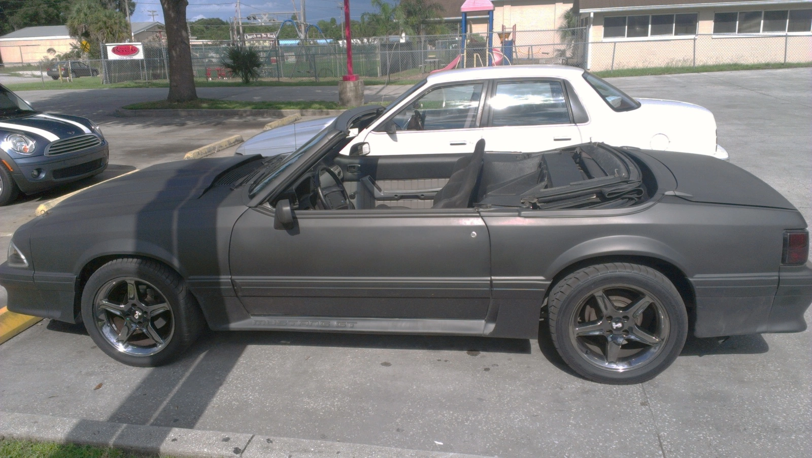

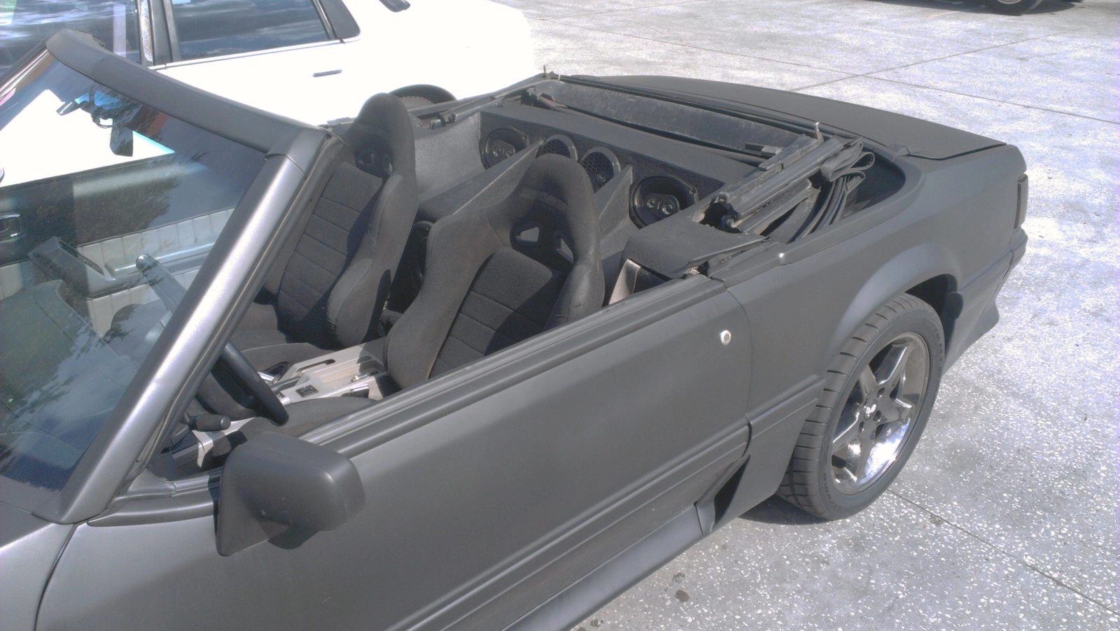

  17. i have about 3yrs in this build so far. i learned how to do body work, paint, fiberglass, i even made custom door panels and speaker box. took forever to lay all that glass by hand. IMAG0066.jpg IMAG0158.jpg
