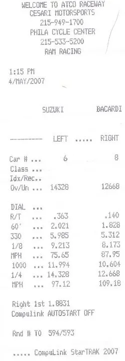

OK, good topic and think I can add to the conversation with my personal experience.
Setup: First time at the track, my mods were PI intake, PI cams, Steeda Pulley, FRPP catback and 3:90 gears (stock plenum and TB). I ran a best of [email protected] mph with a 2.02 60'.
Added TF plenum and 70mm FRPP TB, DRs and welded in Bassani mufflers into the FRPP catback, so this isn't a test of only the tb/plenum, but it's fairly close. and went back a few months later.
With these mods, I ran a best of [email protected] mph, backed up by a number of 13.8s and others in the 13s. My take from this was that with my previous mods, adding the TB/Plenum helped unleash some power that was there, but was being restricted.

I thought I gave pretty specific information about pre and post Plenum/tb combo:shrug:. Don't trust? DRs don't add any speed (mph) and muffs were already upgraded over stock and don't add much anyway. If you want actual proof, here's the runs and there are vids on my photobucket page if you really want to see some runs. I'm not saying it works all the time and to every situation, but for me the tb/plenum made gains.
Pre TB/Plenum
Post Tb/Plenum (plus mufflers and DRs)

A timeslip from may vs a time slip from october? I imagine D/A has alot to do with that time slip :shrug:
