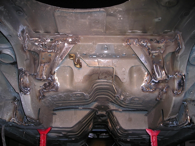

No wheel hop it shifts from side to side Im sure the bushings are woren out . I have only had the car for a short while and have basicly replaced everything I come to that needs attention. But what is a Torque box?
As has been said, it's either worn out control arm bushings (which can be remedied by installing quality aftermarket control arms) or your torque boxes are pulling apart.
Here's a good photo of the upper & lower torque boxes:
