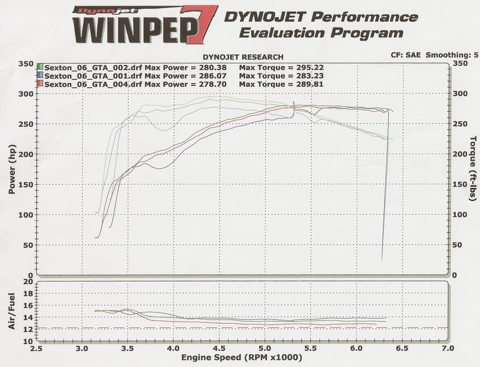

    Cars are normally in 3rd gear for a dyno pull. They usually start the pull at around 35 MPH and go until redline. 3rd gear is a good gear due to it can pull good from 35 all the way up to and over 100 depending on mods. I'm not real familiar with all the different auto trannies, but the newer ones need a specific tune written to lock the converter during the pull or otherwise it locks and unlocks and creates "spikes" on the graph and makes it difficult to get the most accurate reading in the upper RPM range. The best shifting technique is to run it up near redline before shifting. Eventhough you'll pass your peak power levels (usually), you want to carry it higher so that when you shift, the RPMs don't drop way below your power curve.

    Here is my dyno graph from last summer. You can see how the first pull had "spikes" near the top from the converter locking/unlocking. The next few pulls they were eliminated as he wrote in the tune to keep the converter locked the entire time.
