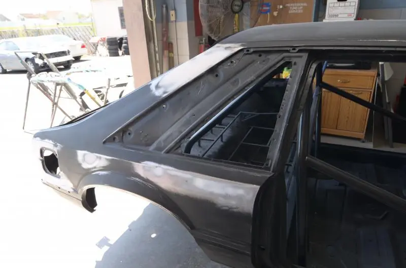

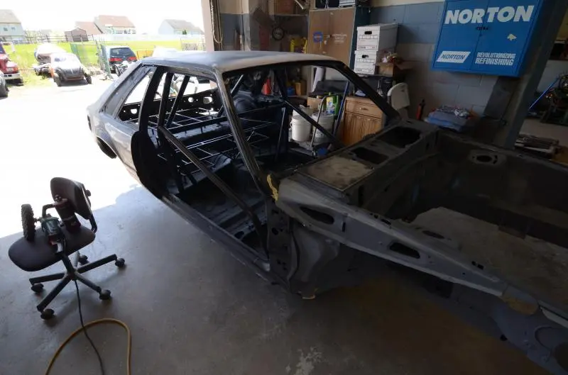

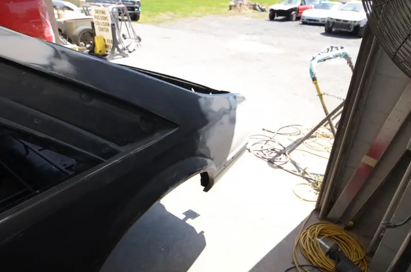

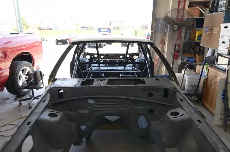

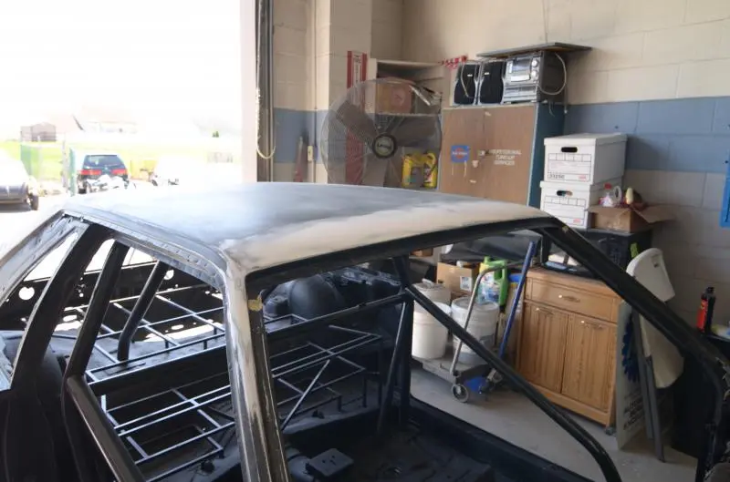

    Body work is all finished up. It needed less filler than I thought. They were able to tap out some of the tiny dents in the body. The front edge of the roof was the worst part. Not sure how the previous owner managed to get a bunch of dents up there.
    [​IMG]
    [​IMG]
    [​IMG]
    [​IMG]
    [​IMG]
    Next step is 3-4 coats of urethane primer and then blocking. They will probably be shooting the primer tomorrow. Depending how it blocks out, it may go back in the booth again for a few more coats of primer and more blocking. They said I did a good enough job in the engine bay that they will probably only need to seal it. It shouldn't need anymore primer or sanding. I'm happy to hear that because that will save me some green.
