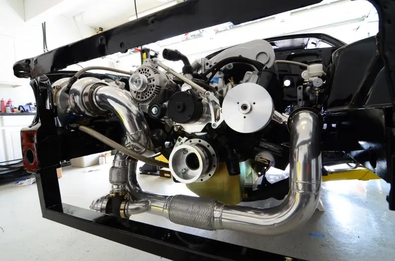

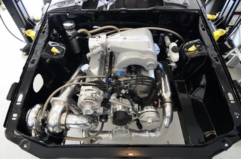

    The pictures are a little misleading. It's not as close as it seems. I do have a blanket for the turbo though, and I'll probably end up wrapping the downpipe as well after I get the car tuned and everything.

    Shiny, but still looks tiny:hide:

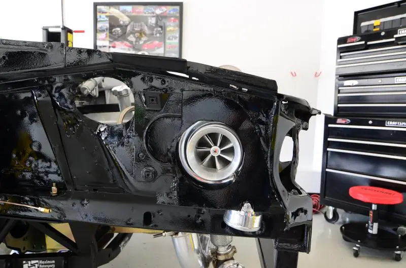

    Is that a custom turbo setup or is that a kit?

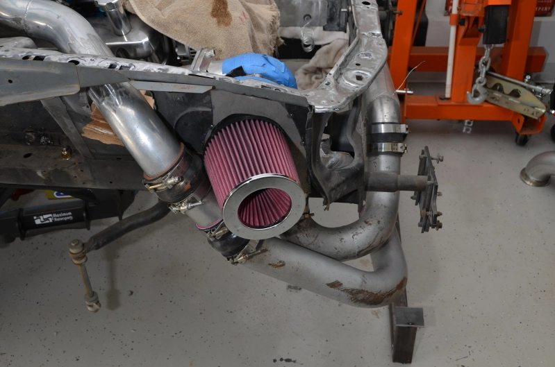

    I want to know now why you orientated the turbo like that could you still put a filter over that?

    The kit started its life as an HP Performance kit. I had to chop it up and re-design much of it to work for my needs. The modifications to the kit are on pages 3, 9, and 11.
    I wanted to be sure that the turbo inlet was getting fresh, ambient air and not heat-soaked engine bay air. I also like the way that orientation looks compared to other kits that have the inlet directly facing the back of the passenger headlight.
    I bought a special filter from S&B that has an angled neck. Fits great. Here's a picture when I mocked it up.

    Yeah i figured that was the reasoning when i go turbo ill probably orientate it the same way it looks crowded when turned to the headlight at least i think so
