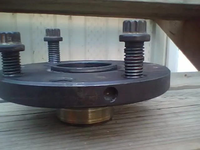

    funny i just got tired of mine 2 months ago..changed the pinion flange...100 percent viberation gone..
    ive had this battle with another site,,,
    the driveshaft is balanced on a machine with slip yoke and flange yoke as a unit...
    the pinion yoke only centers the driveshaft in the rear,
    the output shaft on trans centers the front,
    the pinion yoke is balanced on its own...
    my pinion flange..see hole in side...thats how they balance it,they remove metal

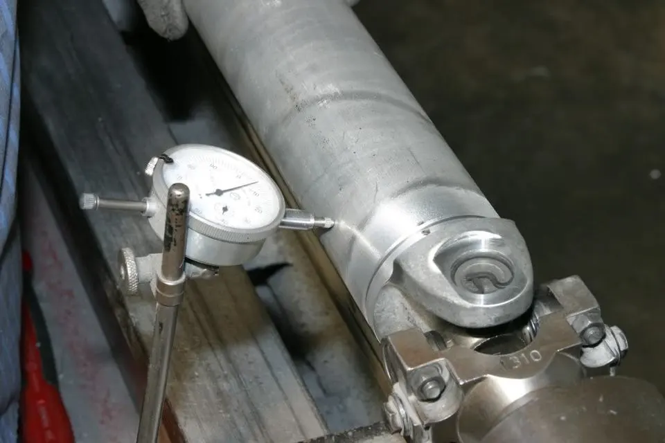

    here is a shaft being made in a balancer,,notice its bolted here with ubolts,,,ours would have a flange setup
    [IMG]
    here is fixture our style bolts to in balancer...notice other holes...thats for other size flanges...the lip in middle centers shaft just as pinion flange
