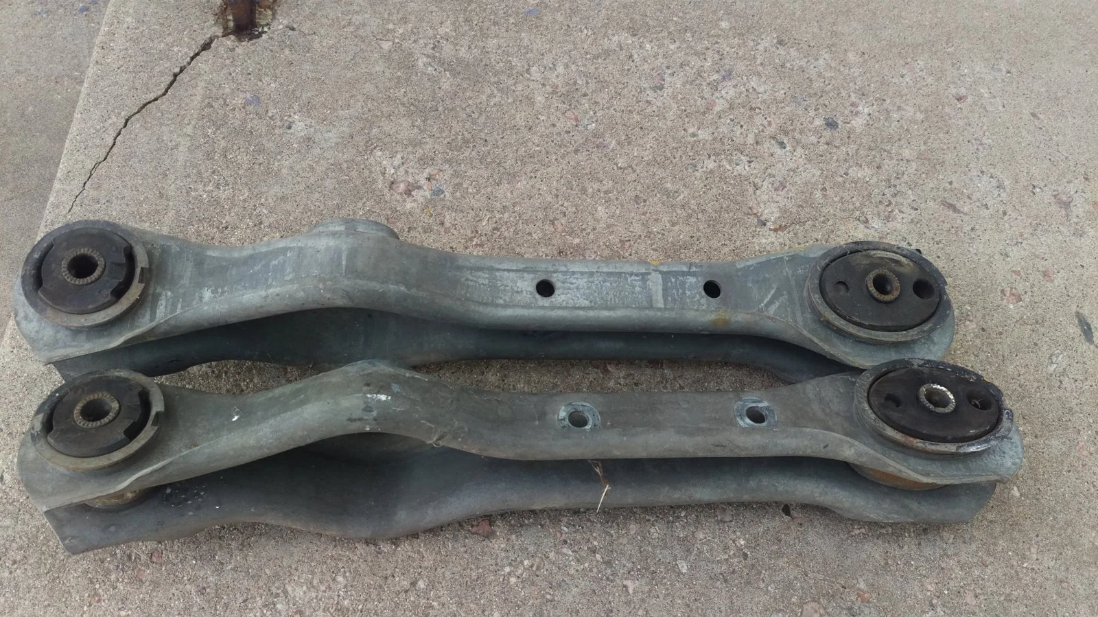

Boy, this is going to be a long shot and probably very controversial. Without all my normal details, I'll just ask. Does anyone have a factory fresh set of rear lower control arms for an 87-93 car? Or know where I can get them? I'll try to answer replies on my phone after this post the best I can so sorry ahead of time if it's short.

What do you mean by factory fresh? I have a set that were removed from my '93 at around 30k miles and are in great shape.

Oh no....I have MM control arms now. I used to have all Energy Suspension bushings, mounts, etc. Hated it. My whole thinking is to put it back to factory. I've replaced every single performance suspension piece back to factory trying to find the harshness. Only thing left is these control arms.

I have the MM HD lowers with stock uppers. I never really thought of them as harsh at all.
I spoke with Maximum Motorsports yesterday. I gave them the scoop on what I wanted to accomplish with the car as well as what the current suspension setup is. They highly suggested two changes. First is to change from the HD lower rear controls arms to their Sport Lowers. These have poly at both ends and no spherical bearing. The other mod would be to get rid of the Ford Racing B springs. Sadly these aren't very old...lol. I actually had the Ford Racing C springs in for a long time and man that was awful. Should have expected that as I bought them from a guy that put them on his car and hated them because of harshness. Duh!! They suggested finding some H&R Sport Springs used maybe since funding is terrible right now. I'm honestly tired of swapping springs because it costs me an alignment every time I do. Thoughts? Opinions? :)

The sport arms are new, but honestly since I ditched the C springs I really don't notice any harshness in my rear with the HD arms that have one spherical bearing. Given the cost of new arms, perhaps hold off on buying new arms til you change a few other items?

So I'm reasonably certain that the rear lower control arms are responsible for the screeching sound as the rear end goes over bumps. This is just one part of the harshness I've been describing. My choices according to Maximum Motorsports are a set of the new Sport Lowers or new urethane bushing kit for the ones I currently have. Those bushings are $40. Now I need to decide if I want to just sell these and put that money into the new Sport version. I'd hate to spend more money on these and it not do anything. MM suggested pulling these arms and greasing the existing bushings and putting them back on to see if that helps. They have grease fittings but they said I need to grease the outside of the bushings good (where it touches the box) and see if that helps. I hate going to all that trouble. I have no lift so I will be working on the ground. Forgot to ask which grease to use???
