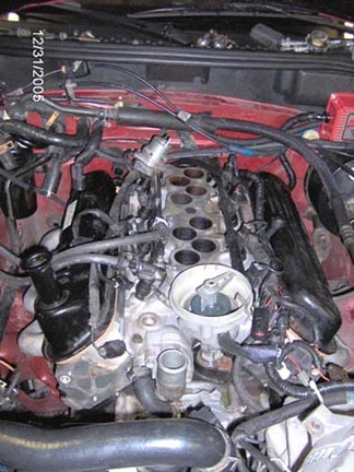

    Hi
    Saturday evening Jay and I worked til 5pm.
    This is what it looked like when we started Saturday around 10am.
  11. Pops Fun Active Member
    Member Since:
    Feb 16, 2003
    Message Count:
    845
    Likes Received:
    Trophy Points:
    28
    Location:
    Cincinnati, Ohio
    Installed the dizzy, adjusted the valves, installed the intake
