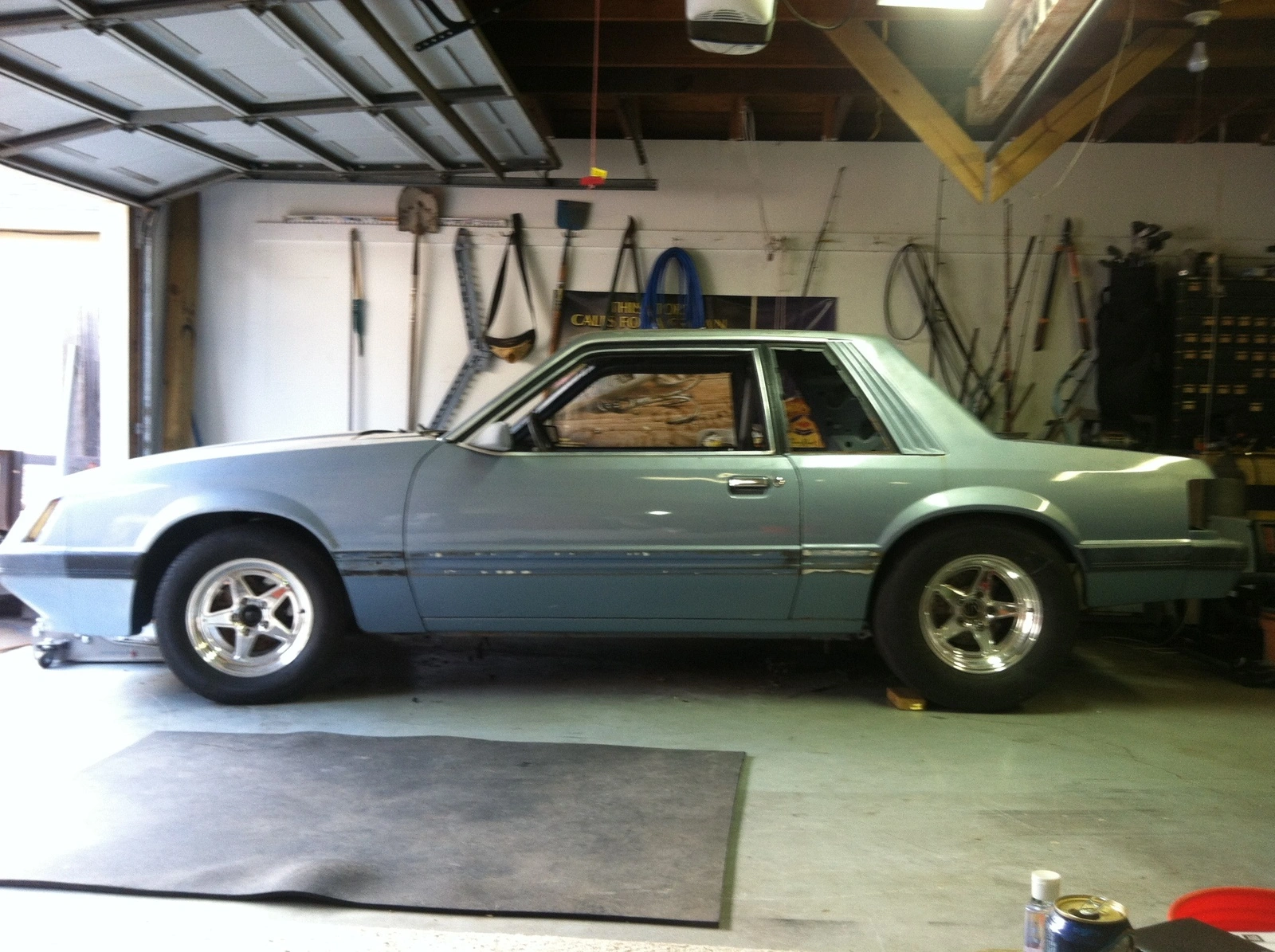

    Touchdown.
    #327
    stangboy likes this.
  8. madmike1157
    madmike1157 the humor is still lost on me
    SN Certified Technician Mod Dude
    Joined:
    Messages:
    4,073
    Likes Received:
    1,165
    Trophy Points:
    164
    Location:
    Birmingham, al
    Is this the car that is getting the LS?
    For some reason,..I'm thinking that you are building two cars. Are you?
    #328
  9. hoopty5.0
    hoopty5.0 Mustang Master
    Joined:
    Dec 14, 2010
    Messages:
    2,575
    Likes Received:
    804
    Trophy Points:
    134
    Location:
    SW Houston
    Nope, just the '85. Sold the green 87 for $300.
    #329
  10. MikeH686
    MikeH686 Mine is only two inches though.
    Joined:
    Oct 11, 2011
    Messages:
    2,055
    Likes Received:
    396
    Trophy Points:
    104
    Location:
    Waldorf, MD
    Hows it feel to be on four wheels?

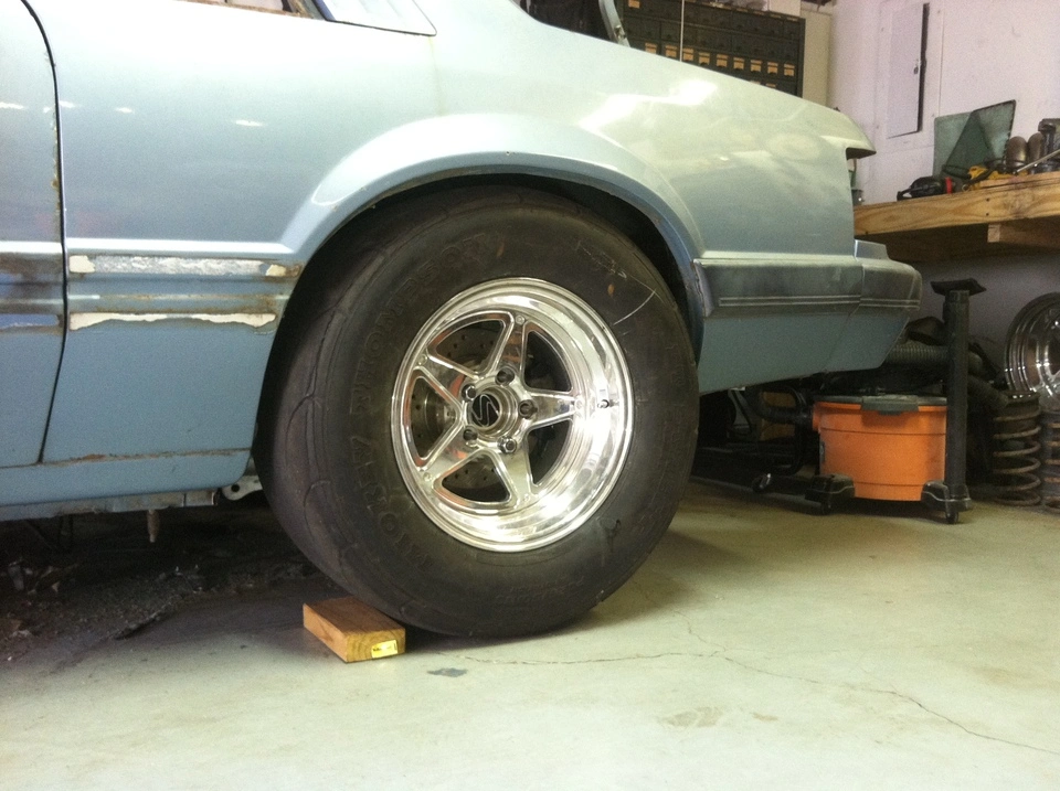

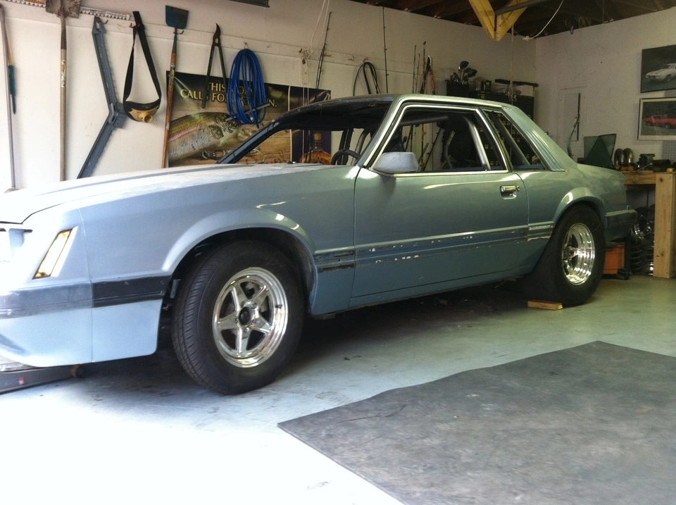

  11. hoopty5.0
    Joined:
    Dec 14, 2010
    Messages:
    2,575
    Likes Received:
    804
    Trophy Points:
    134
    Location:
    SW Houston
    Great, actually. I'm happy with how it sits. In fact, I'll whore it out a little more now that I was able to upload some more pics....

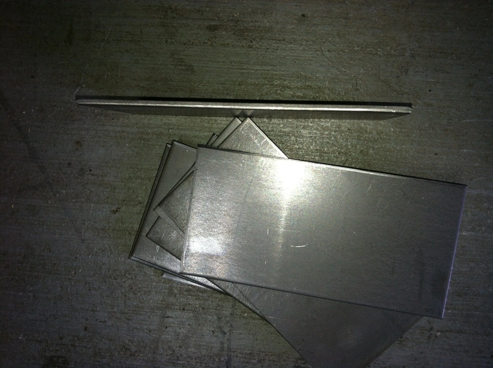

    So on to the next order of business - the cage. I got these plates from Wolfe when I got the 10pt conversion:
    They're 3"x6"x1/8". Is there an NHRA requirement for what the mounting plates need to be? Im sure there is, just dont know what. Wanna be sure before I get after the welding again tomorrow.
    #331
  12. hoopty5.0
    Joined:
    Dec 14, 2010
    Messages:
    2,575
    Likes Received:
    804
    Trophy Points:
    134
    Location:
    SW Houston
    Ok...I'm confused - NHRA rules state that I have to have 6"x6"x1/8" plates welded to the floor to weld the cage to. Somehow I ended up with 3x6 plates.
    Which brings the next question - Can I weld 2 plates together? @84Ttop
    #332
  13. hoopty5.0
    Joined:
    Dec 14, 2010
    Messages:
    2,575
    Likes Received:
    804
    Trophy Points:
    134
    Location:
    SW Houston
    I got on YB and asked about the plates. One comment says its ok to use a couple plates since it'll help conform to the floor better... Waiting for more definitive response.

  14. madmike1157
    Joined:
    Messages:
    4,073
    Likes Received:
    1,165
    Trophy Points:
    164
    Location:
    Birmingham, al
    I'm no NHRA tech,..but I think I'd prefer two smaller plates and weld them so that I could get the bar as close to the sides/back w/o having to bend 1/8" plate at a 90.
    #334
  15. hoopty5.0
    Joined:
    Dec 14, 2010
    Messages:
    2,575
    Likes Received:
    804
    Trophy Points:
    134
    Location:
    SW Houston
    So as long as its 36 sq in, Im good, no matter the shape?
    Guess I have some searching to do on google

  18. madmike1157
    Joined:
    Messages:
    4,073
    Likes Received:
    1,165
    Trophy Points:
    164
    Location:
    Birmingham, al
    Yeah,....well don't blame me when you build a car based on my "tech rule book" and can't get into Houston's local NHRA track.
    A SN certified tech is just like an A.S.E. certified tech.:rolleyes:
    Only with out the A,..or the E.
    I still don't know what the N stands for.....................
    Noobz?:shrug:
    #338
  19. 84Ttop
    84Ttop They make new pistons every day, so why worry?
    Joined:
    Jul 2, 2009
    Messages:
    3,574
    Likes Received:
    1,622
    Trophy Points:
    144
    Location:
    South Jersey
    I personally only have used a single plate. Is this a 6,8,10 point? If it is a 10 point and going to be certified your best bet is to call and ask your tech inspector. This is cheap insurance and most of them are happy to answer a few small questions before the ride out waste there day and fail your chassis cert. If it is a 6 or 8 point I see no reason not to just weld the two plates together.
    #339
  20. hoopty5.0
    Joined:
    Dec 14, 2010
    Messages:
    2,575
    Likes Received:
    804
    Trophy Points:
    134
    Location:
    SW Houston
    its a 10 pt, looking for 8.50 cert
    #340
