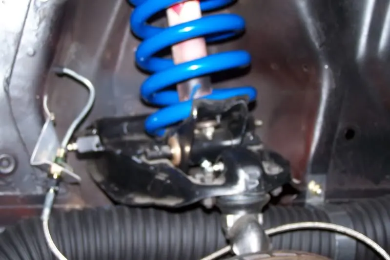

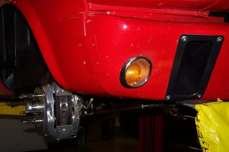

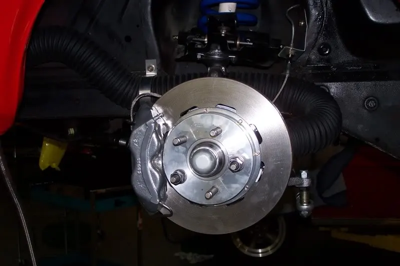

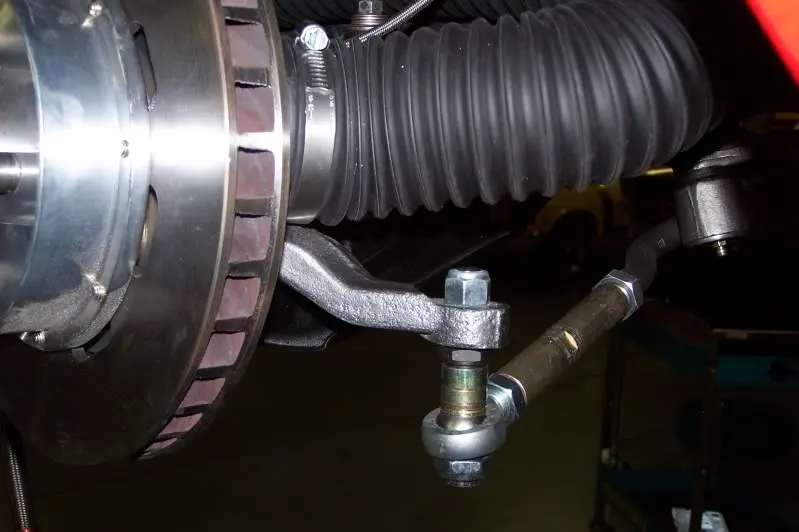

    I'd like some more tech on the Granada spindle. Why is it so much better than the 1970 Boss 302 spindle?
    Here is my '70 big bearing spindle with Lincoln brakes, stock suspension (required by vintage racing rules), big cooling ducts, and a few other tricks:
