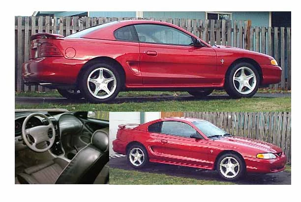

    I have 17's on my sons, and it came with 18s. works fine. go with 245/45 just like the GT and you will be fine.
