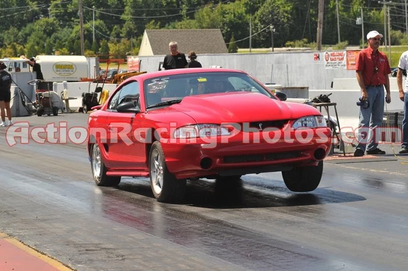

I did better today but still have some work to do.
Ran two 12.8's with 1.6 60' times and a two 13.0's. i was playing with the settings on each run. The 2 runs that were 12's and 1.6's the fronts were set at 3 and the rears at 6
if you looked at vid 3. it does show that right rear squatting more than the left. that would go with the left front lifting more.
An airbag in the right rear spring would help level that rear. That would be the cheapest way to go. The better but more expensive way would be a rear sway bar attached to the frame.
