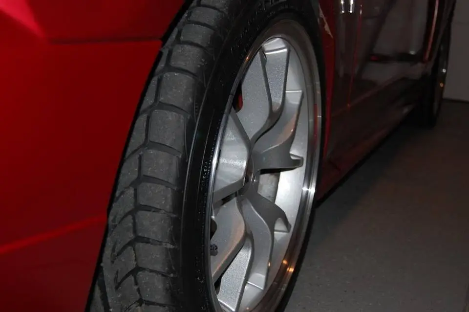

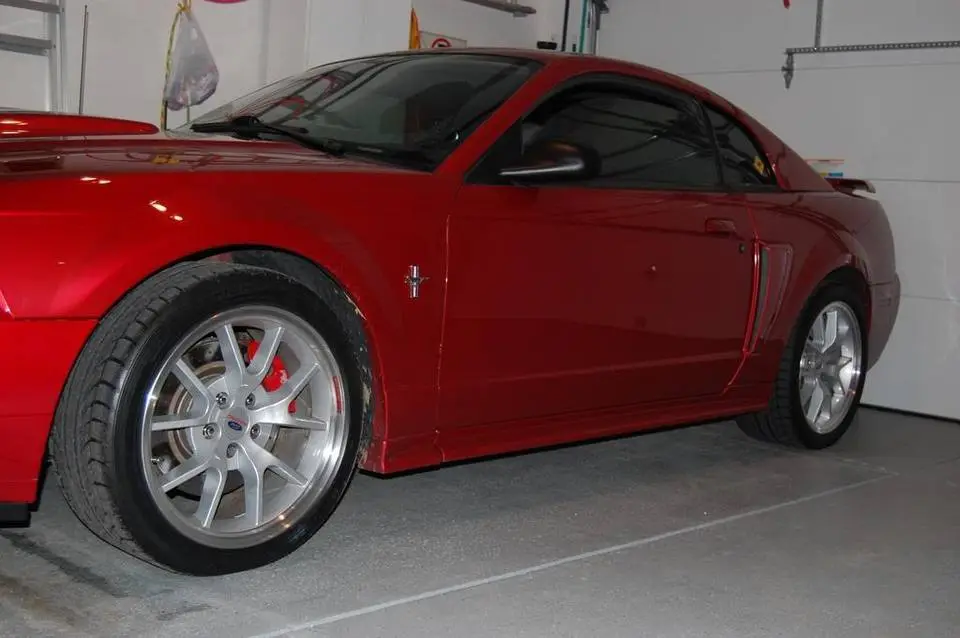

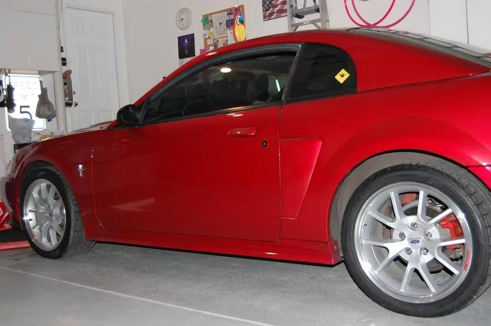

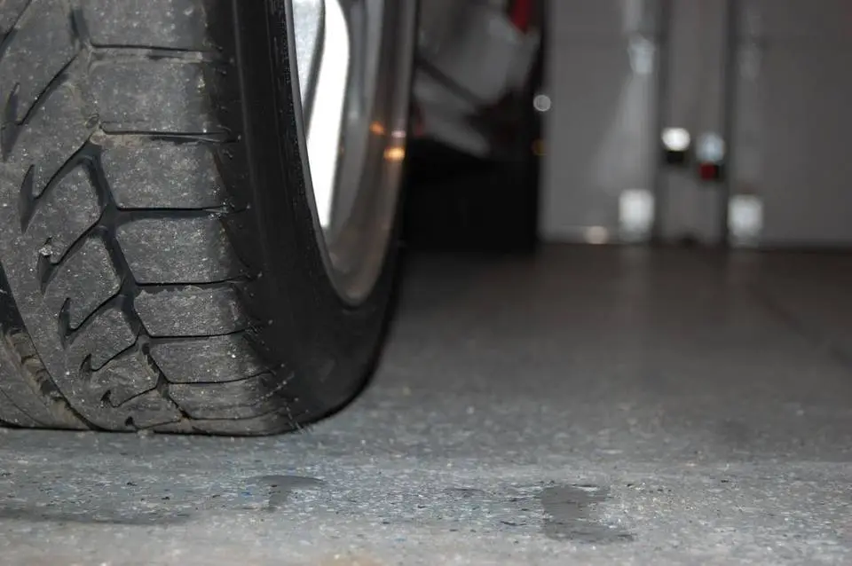

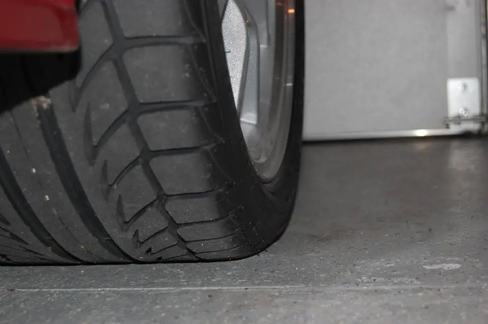

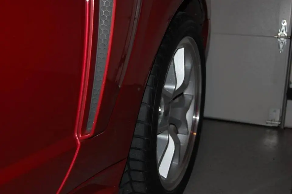

    Okay, I went with 245/40ZR18s in the front and 275/35ZR18s in the rear. The results weren't that much different, although visually it almost makes the spokes look like they're more flush to the face of the wheel on the fronts. I definately like driving on them a lot better (had 275 up front before...steering in the front was a drag) and the handling feels crisper, although I am coming off of a set of Blizzaks. It's a subtle difference, but in person me likes it...
