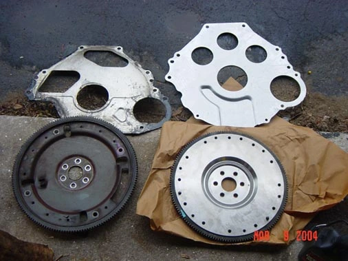

    i figured they were different just didn't have a picture thanks :nice:

    thanks that confirms i have the correct one....

    haha ya there is a difference between an auto and a manual tranny block plate. I found that out the hard way.. When I tried to put my clutch cable in and it wouldn't work cause the plate was in the way :notnice:

    if your top bolt is stripped and the block plate is partially broken then you should change both of them. i had a starter issue and went through 6 starters before i changed the block plate and bell housing. my bottom hole strippied out and i re-tapped it but it must not have been lining up right. thats whats probably happening with your starter. i would change the bell housing. you can get them from ebay or craiglist fairly cheap.
