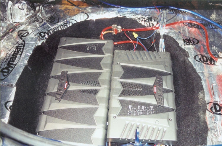

    Not much... Just clean up the wiring (even though it is out of sight). Fused distribution blocks for the power to the amps (this pics scares me [IMG]).
    And of course.... Upgrade the grounds.
    Other than that, the finished product looks GREAT [IMG]

    Ok, I also am running a 1501D and a mid and high amp in my '93. I have the 3g upgrade running 120 amp. I have been running this setup for years and it has functioned flawlessly. I did recently add a cap, but it wasn't absolutely necessary. I think you just got a bad alternator. But, as stated, double check your grounds. You did everything well, but use a meter, as that is the only way to truely tell how the grounds are functioning. And on a side note, 98 stang, please get rid of that wire nut in the picture, those are for house wiring... I'm begging you...

    Nice pics. My amps are mounted upside down on a hinged home made rear seat delete.

    Cool, thanks for the input...you actually can't see the ground wires in this pic...they attach right below where the hood latch is located...those are only the power wires and the remote turnon wiring at the top there...

    This was the 1st stereo I ever did...how does the wire nut affect anything if you can't see it? Functionally, it is the same as any other connection method...right?

    This was the 1st stereo I ever did...how does the wire nut affect anything if you can't see it? Functionally, it is the same as any other connection method...right?[/QUOTE]
    You are correct, as long as it stays on there, it is making an electrical connection. However with the vibration from the sound waves coming from the subs, it may fall off. I would recommend slodering, or butt connectors if the soldering isn't practical.:nice:
