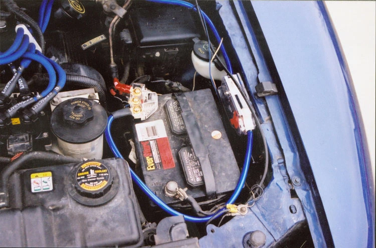

    Thanks! Are you referring to right here:
    [IMG]
  7. 95Vert383AOD Member

    WOW you need a ground wire from the battery negative to a clean piece of metal thats the Same size or bigger than that blue wire. Also the negative wires off the Amp should be as big as the positive wire on the amp.

    my ground off the amps is as big as the power wires...you just can't see them in any of the pics...
    no alternator wine...
    what is the issue with a small ground from the battery? what can/will happen?

    Well your charging system uses the battery as a buffer. If you start drawing heavy wattage it will work your Alternator more. Also grounding your amps is so that threw the chassis it eventually grounds to the battery. so those little wires coming off the battery are defeating the purpose of you having thick ground wires in the trunk. I have seen many people get the Alt. whine from the factory wires. i think you lucked out because the factore ground would def. give me that whining noise. If your voltage needle moves when the bass hits then a better battery ground may also help stabilize that.
    I suck at explaining these things but i do know ground wires have to be as thick as positive!!! At the battery and Amps.

    DC electricity travels in a loop. It is just as important to provide a path back to the battery with a wire capable of carrying the higher current.

    Thank you for the info....that makes sense....so what should have happened since I am not set up that way? Battery going dead? Alternator?

    you aren't seeing the full potential of the amps... less efficient... probably not an audible difference but would help the amps if you upgraded your grounds.
