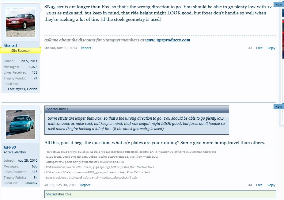

i have an 86 coupe. i have the cheap sleeve coilovers and have them turned down quite a bit to get down to the stance i like. well my stuts are bottoming out quite frequently. for the guys running really low cars, which struts are the best? ive heard conflicting stories about running sn95 struts. i just need to know which struts allow for the drop. part no and links is greatly appreciated.
