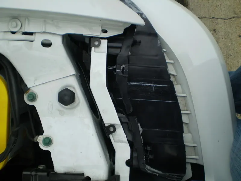

    TL's probably won't fit. You're going to be pushing it for space.
    [IMG]
    Those are RX330's. That's what I'm going with and what you need to look for.

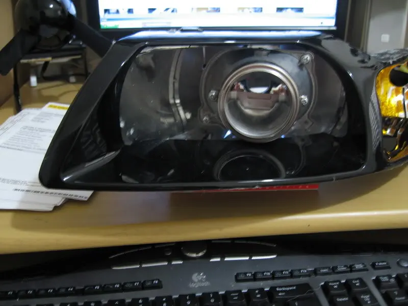

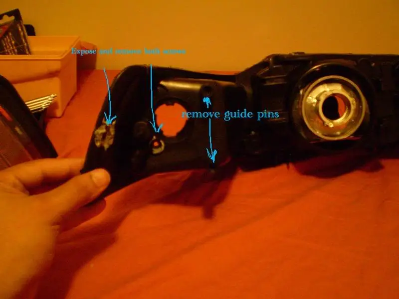

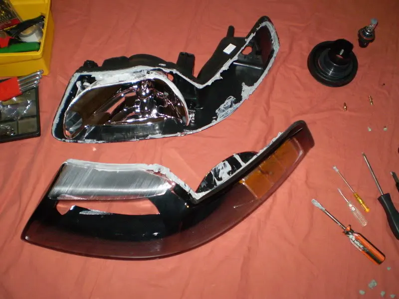

    Taking the headlight apart
    ok, Preheat oven to 250-270 Deg F. :eek:
    Remove bulbs, rubber hoses, 2 hidden screws, and the guide pins.
    Turn off oven and put headlight in for 5-7 mins. This loosens the glue.
    CAUTION!! HOTT!!:rolleyes:
    remove from oven and start working the lense apart. This is a bit tricky to get started, try at the turn signal first and work your way around. You may have to reheat the oven and place the headlight back in for a bit.
    Use various flat heads to keep the area you seperated apart while you spilt futher.
    eww messy
    [IMG]
    [IMG]

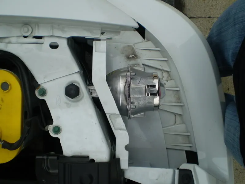

    MAKE SURE IT FITS!
    hehe

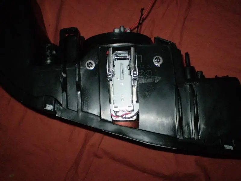

    Ok, don't start cutting until you know exactly where the projector is going to go. I started to try and center the projector and started hacking at the casing.:nono: Carnage..
    Once you have the rear casing off. Restall slider pins and mount in the car. Helps to see where the projector needs to sit.
    [IMG]
    Then you want to visualize where the projector is going to go. make sure there is enough clearance for the bulb and the ignitor.
    Looks like the TL's are pushing the limits on the size of the headlight. For anyone else I say go for the smaller ones out there. This can be done but its going to require fabbbing up some flashing(more on that later), and alot of modifing of the internals.

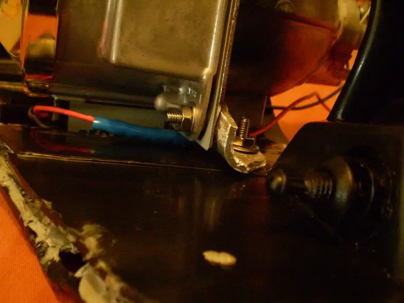

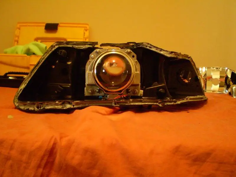

    [IMG]

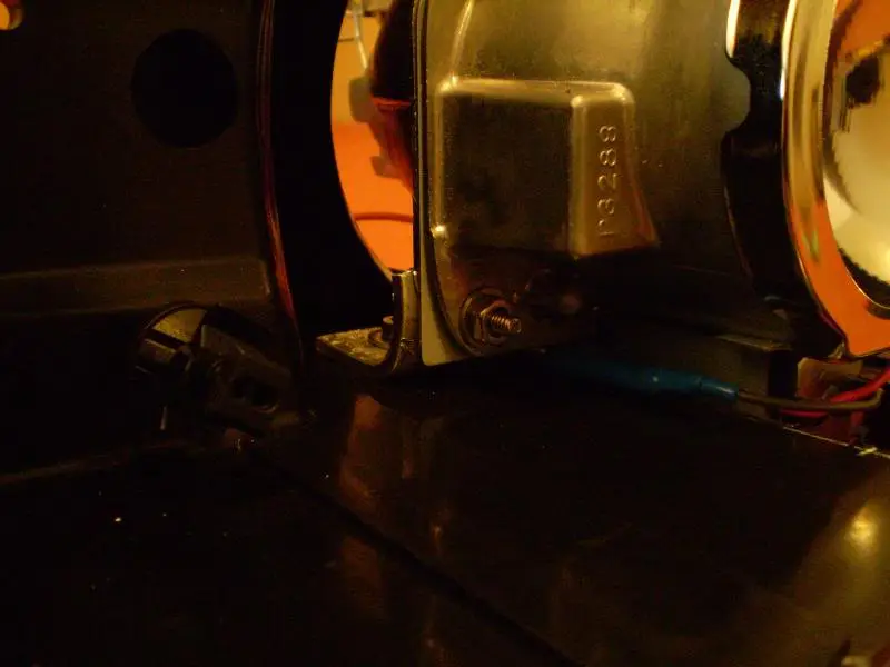

    Once your sure its can be done, you can start laying out where to mount the projector to the casing. Since these are so big, I cannot use the stock adjustments on the headlight. they control just the refective bowl, not the entire light. So, I needed to mount the projecttor directly to the casing.
    [IMG]
    [IMG]
    I made some angles out of the alum. stock and used a long screw to the back of the casing for adjustment. All of these will come into play to level and properly aim the beam. Im waiting for it to get dark. Going to grab some before pictures also to compare.
    [IMG]
    [IMG]

    How are you going to adjust for horizontal beam alignment? Your mounting solution doesn't seem to provide for that. If you search for a thread by my friend Farrukh ("JNC" on HIDP), he shows a method for allowing for horizontal alignment.
    Also keep in mind that the stock headlight housings only allow for a certain degree of left/right alignment, so make sure the spread of your steps is within the stock alignment range.
    Looking good so far, but you have to consider how you're going to cover up the top, bottom and back for waterproofing measures.

    The bracket on the right im leaving stationary, may put some washers to level it out with the left bracket(that what you mean?). The left braket is slotted to aim left/right. There is a long machine screw on the top left of the projector for up/down adjust. Also it doesn't(more or less cant anyway) need to telescope in or out, the beam of light clears the lip of the headlight.
    I decided to put the harness on in the morning to aim tomorrow. I remounted the turn signal shroud and hacked up the reflector and bezel to finish off the face. I may paint the reflector pieces black and just leave the ring around the projector. Ill see how it looks once everythings in place.
    as for sealing I have some sheets of metal that ill be molding in place and JB/rtv in place. Painting black after thats set. I did this to the 98 and that sucker is holding strong.
    EDIT:
    hehe found the thread, thanks, and its pretty much exactly what I have, just I have to adjust the beams before I can seal the headlight back together. No way to get to the screws after the shrouds are in place.

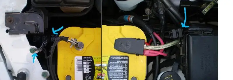

    Didn't get much done today. Just thought Ill keep the pics coming. I was able to install the harness at least. The wires that came with the harness were just the right length. No hanging wires anywhere.
    [IMG]

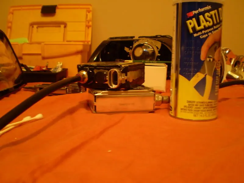

    Waterproofing ballasts
    pretty much nothing done today either. Will try to finish tomorow, long day. see the mess in the backround?
    You can pick this stuff up(or something similar) at any home improvement store. I used this after I fryed one ballast on the 98, works great. Its pretty much liquid rubber. Just put a liberal amount around all the seams of the ballast. DO NOT coat over the breather, thats the middle black circle thing in the front. Usually you want to mount the ballast with the breather facing down. Try not to coat the entire thing either, you don't want to start insulating the heat coming off.
