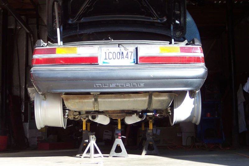

28 or 29 x 10.5 for the track and I really want some 305s for the streetIf you're mini-tubbing, might as well throw some 295's or larger on the back if you can get wheels to accommodate them.

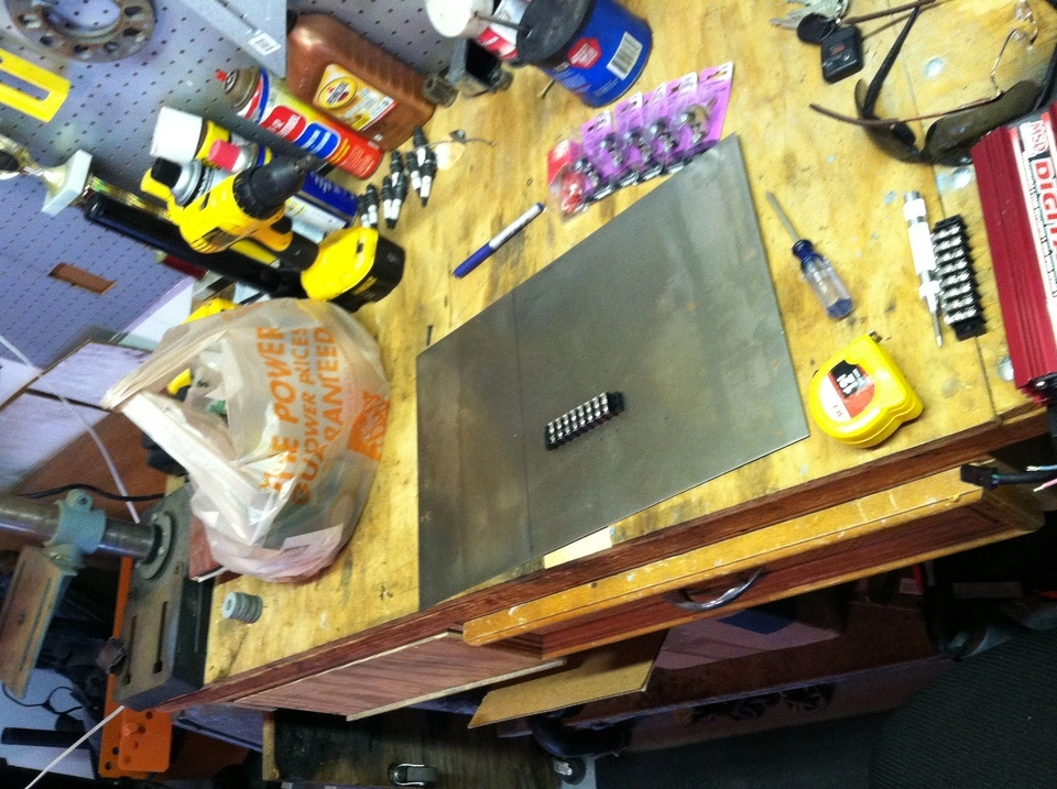

Where would I buy metal in large enough pieces to do that? Home depot only sells small squares.
Look up sheetmetal shops in your area. They'll sell it to you, hell they might even make them for you for $50. There was one near me- Angleton Sheet Metal. They loved doing stuff for hot cars and was always happy to sell me whatever I needed.
Not a bad idea. I think there is a place near me that might.
