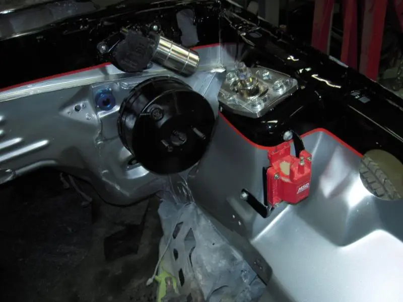

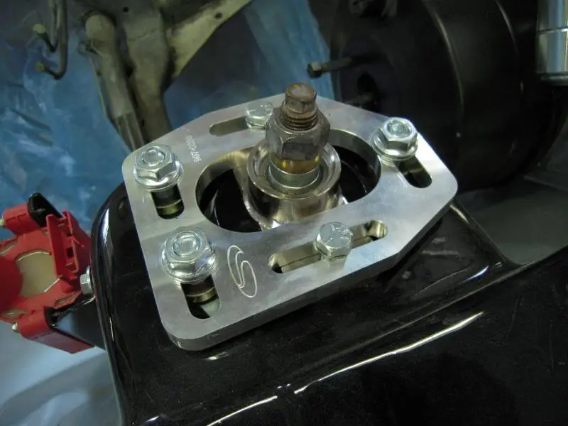

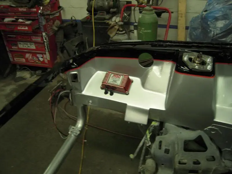

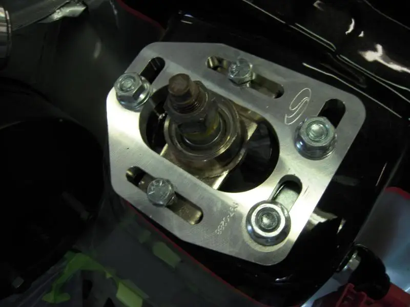

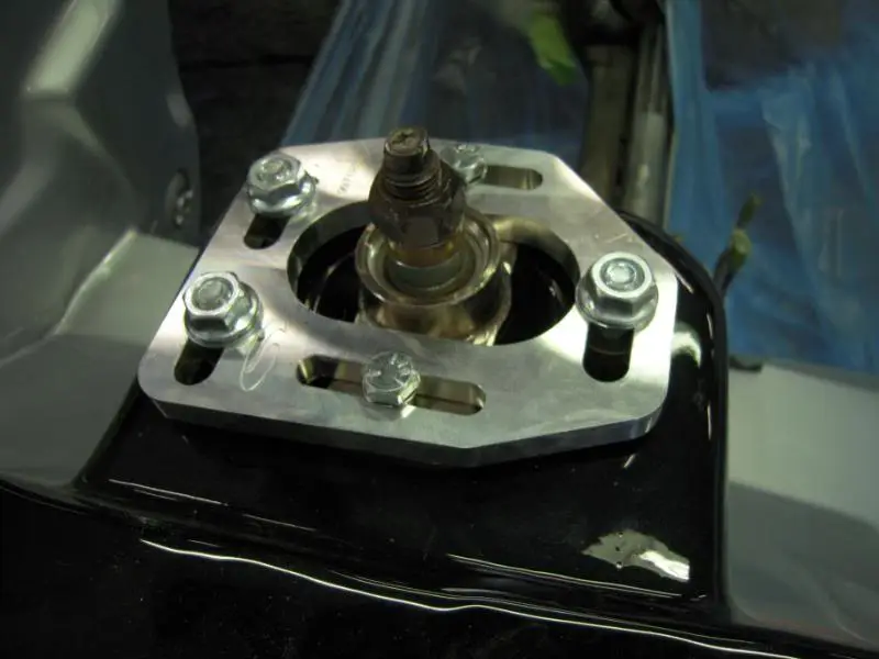

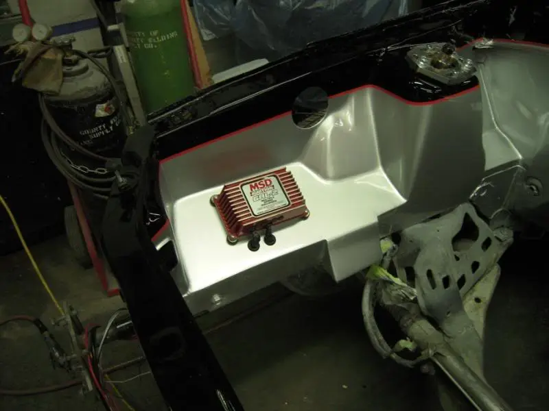

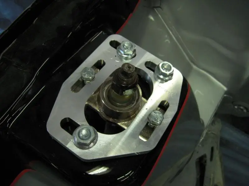

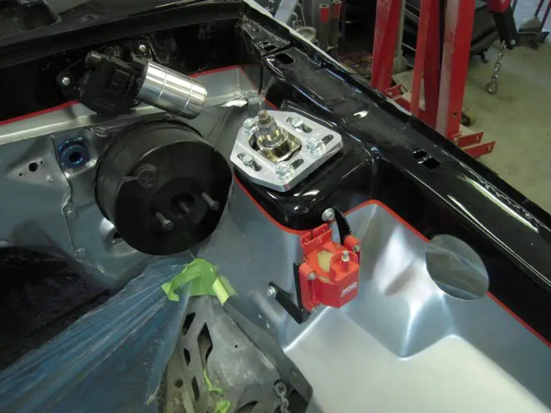

    Got a lil more done tonight after work and on my lunch break. I installed my c/c plates and rear drag springs during lunch and wet sanded and buffed some parts of that bay that were dusty and then istalled my MSD box into place. Last week I also installed my new wiper motor, 93 Cobra booster and firewall adjuster. I also modified the 98 Pedal assembly to work with the booster since the bolt pattern is different. I plan on installing my front end stuff this saturday and then the motor can go in!!!!!

    car looks rediculous. engine bay looks soo clean, an so much cooler then just a plain solid color. i cant wait to see it finished. i think it would be sick if it was done for myrtle this year. you can do it! lol. ill park far away from your car though..dont want everyone seeing my pos lol

    As for the wires, they are going behind the firewall and coming out the inner fender area. The vacuum tree, map sensor, smog relays, starter solenoid are all going to be mounted behind the fenders. The hole in the lower firewall is for the harness that goes to the iac, injectors, water temp sensor, distributor, etc. I'm also going to cut and run the wires for the brake sensor and the wiper motor in the drivers side corner.

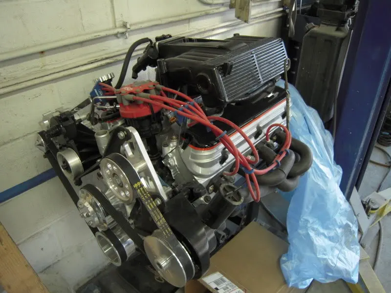

    Took a quick shot of the engine and the valve covers and upper intake on, figured I'd post it on here
