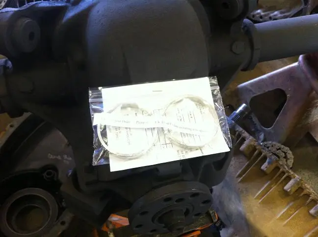

  2. Got my spacers for the rear end. Fox axles don't fit properly inside of SN95 rear rotors so spacers are required. Haven't got around to putting them on yet. Also ordered the proper speedo gear since I have 3.27's now instead of 3.08's. IMG_0153.jpg
