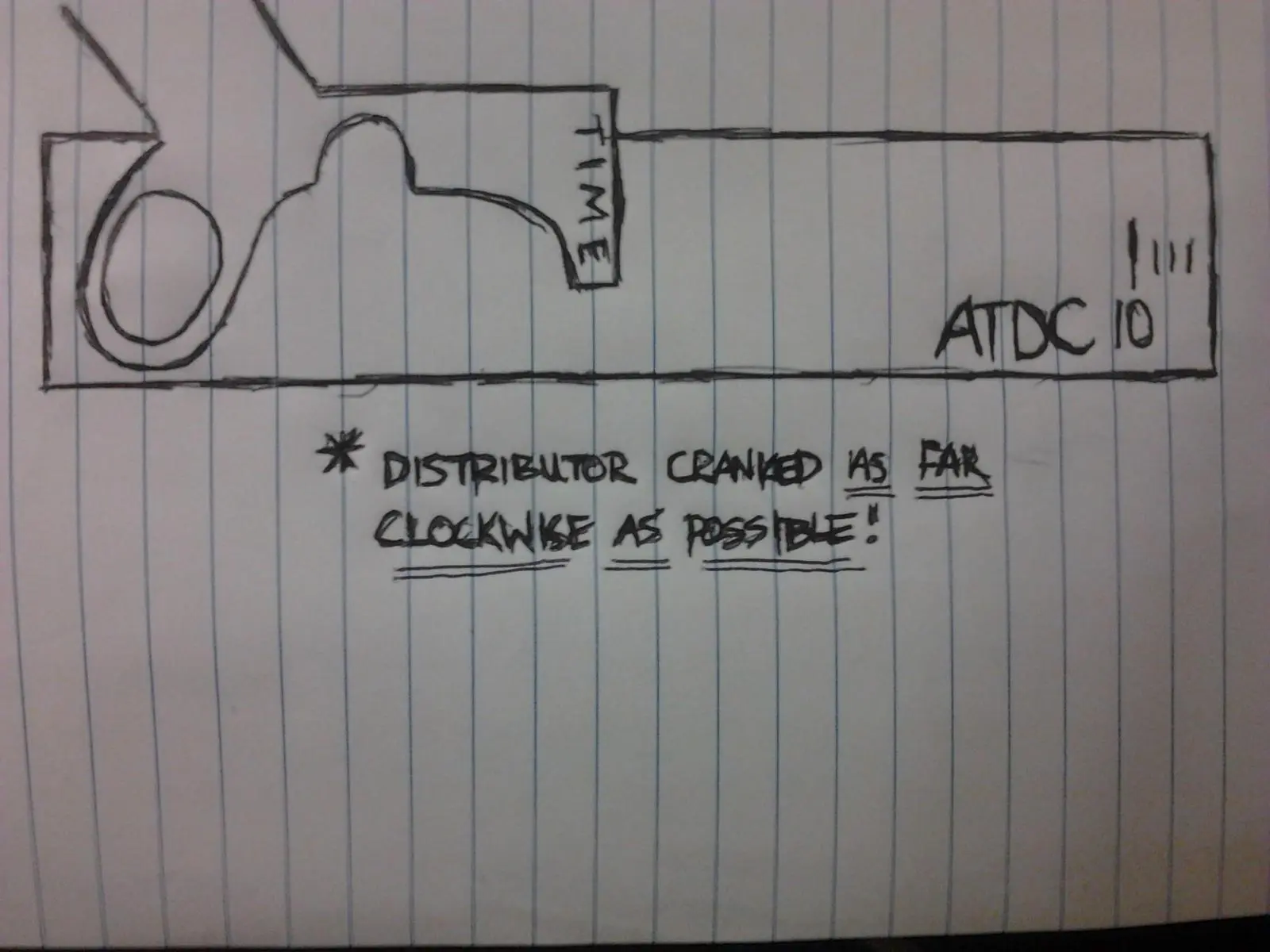

Here is my issue - when I aimed the light at the balancer (yes, with the spout unplugged), my timing was at... I don't even know! But this attached illustration shows how the pointer & balancer hashes were oriented in relation to each other, while holding my distributor as FAR CLOCKWISE as my wires would allow - the pointer is about 2 full inches LEFT of "ATDC 10"!
How could this have happened? I KNOW I was at 14* BTDC before I very tightly cranked the distributor bolt down while by buddy held it in place. I know it... but what should I do now?
It almost seems like I'm 1 tooth off now, because I'm not even IN the hash spectrum... but am I really? Because I remember physically SEEING those hashes once it was set at 14* BTDC, and because it would start up and run fine until I'd punch it... man, I am very confused right now... I don't know whether I should pull the distributor out and re-set it one tooth over or what!?
