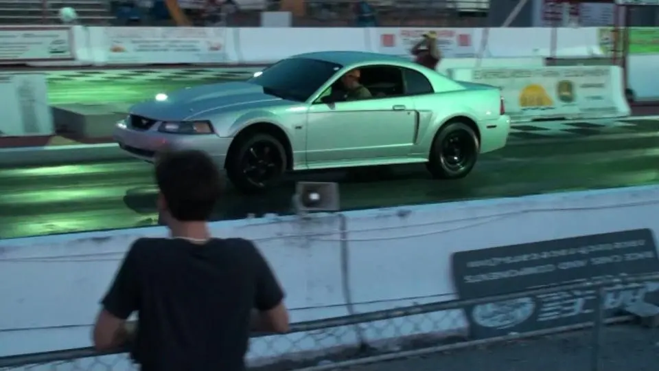

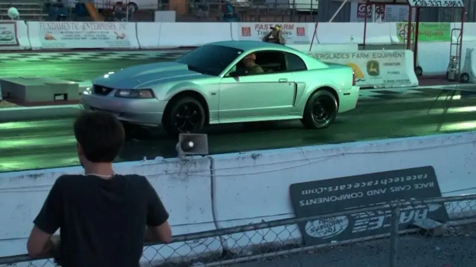

    here are a couple of launch shots I grabbed from a video. 1st one is at the light the next is just after. both from the same run.
    [IMG]
    [IMG]

  8. Nitrous03GT New Member
    Member Since:
    Nov 22, 2008
    Message Count:
    17
    Likes Received:
    Trophy Points:
    dang. the 1/8th tracks here in chucktown are pretty lax, you can click off 7's all day long with no helmet, but the minute you put any kind of slick(even ET streets) they go apeturds and make you have a head condom on.
    edit-
    looks like the pressure is way too high, should have more wrinkle in the sidewall.

    What was your MPH?
    It looks like it's leaving hard, the front end is coming up alot.
