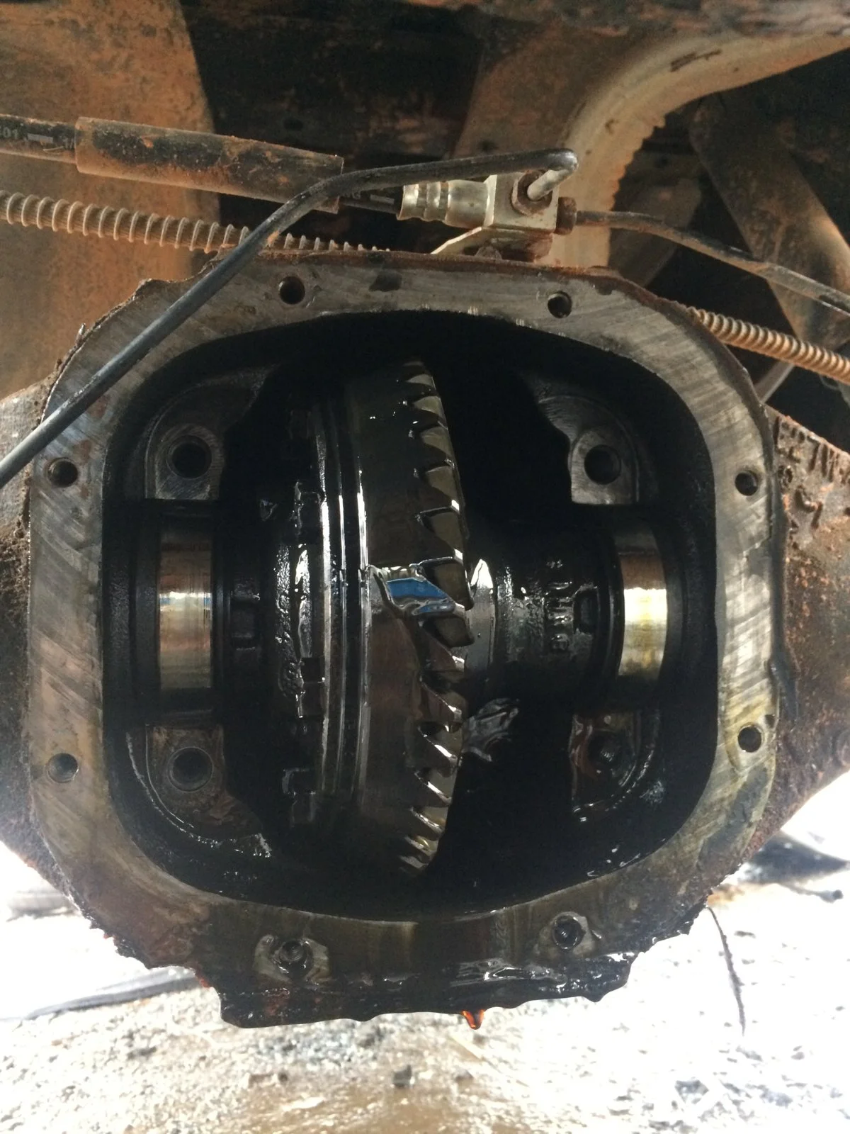

I'm starting a 5 lug conversion on my fox and went to the junkyard to get an axle out of an 83 Ranger. The differential didn't really look like a 7.5 or an 8.8. Anyone know what this is and if I can use the axle? I tried searching for the stamping on the side (E27W-AA) but couldn't find anything.
8 bolt. It looks like a 6.75 used in old Pintos, Fairlanes, Falcons. As far as the axle shaft, maybe someone can share length dimensions to help you...
My research came up with 6.7 Sterling. It was on early Rangers, Foxes, Capri, Mustang II. The tag would read 67S and not 675. It was know as being part of the “poverty” pack as it was used on base models with 2 liter engines etc.
