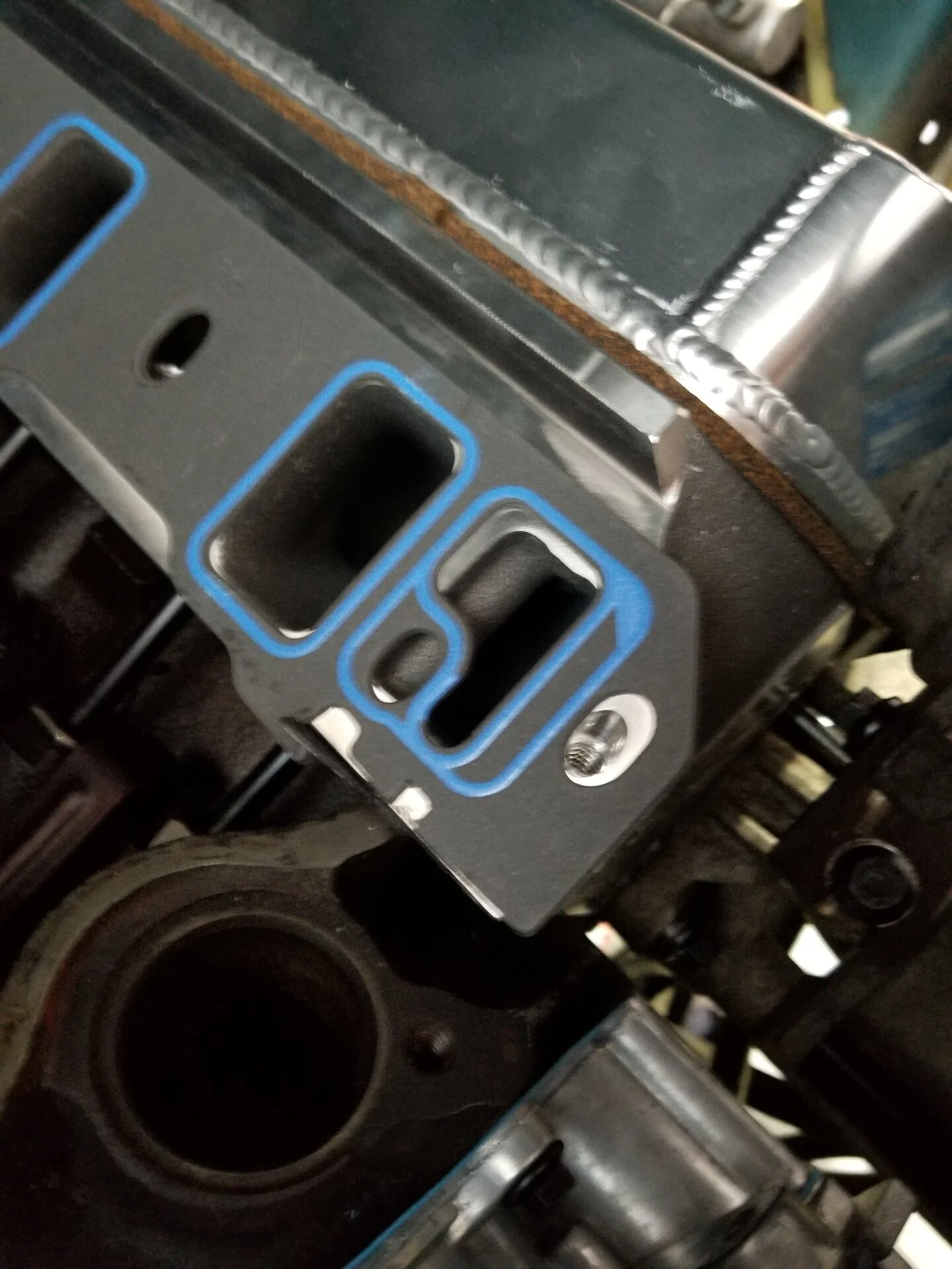

93 teal terror Founding Member Jul 13, 2001 971 62 69 Durham N.C. Nov 8, 2020 #1 Nov 8, 2020 #1 Some gaskets have this smaller port inside the coolant ports, others do not. Why the difference?
7991LXnSHO wanna catch the space herp 10 Year Member Sep 1, 2010 7,388 3,099 194 Kearney, NE Nov 8, 2020 #2 Nov 8, 2020 #2 I’d have to look up the application. Do you have a brand and part number? That corner looks like a problem guaranteed to happen. I would be hesitant to use paper only gaskets when Fel-Pro has steel core ones in different port sizes.
93 teal terror Founding Member Jul 13, 2001 971 62 69 Durham N.C. Nov 8, 2020 #3 Nov 8, 2020 #3 1250 R3's They came with the trickflow gasket kit. I chucked the ones that came with the Holley intake as they were even crappier.
93 teal terror Founding Member Jul 13, 2001 971 62 69 Durham N.C. Nov 8, 2020 #4 Nov 8, 2020 #4 Actually now that I say that this looks like the kit I bought. https://www.cjponyparts.com/ford-performance-engine-gasket-high-performance-set-mustang-289-302-351w-1965-1995/p/M6003A50/?year=1979&gclid=Cj0KCQiAy579BRCPARIsAB6QoIZaHnlO_ucQi6Q3sYw_mIa3hfsuCacyuVnFbBT8oMeUM-FA-OXTntUaAuUVEALw_wcB

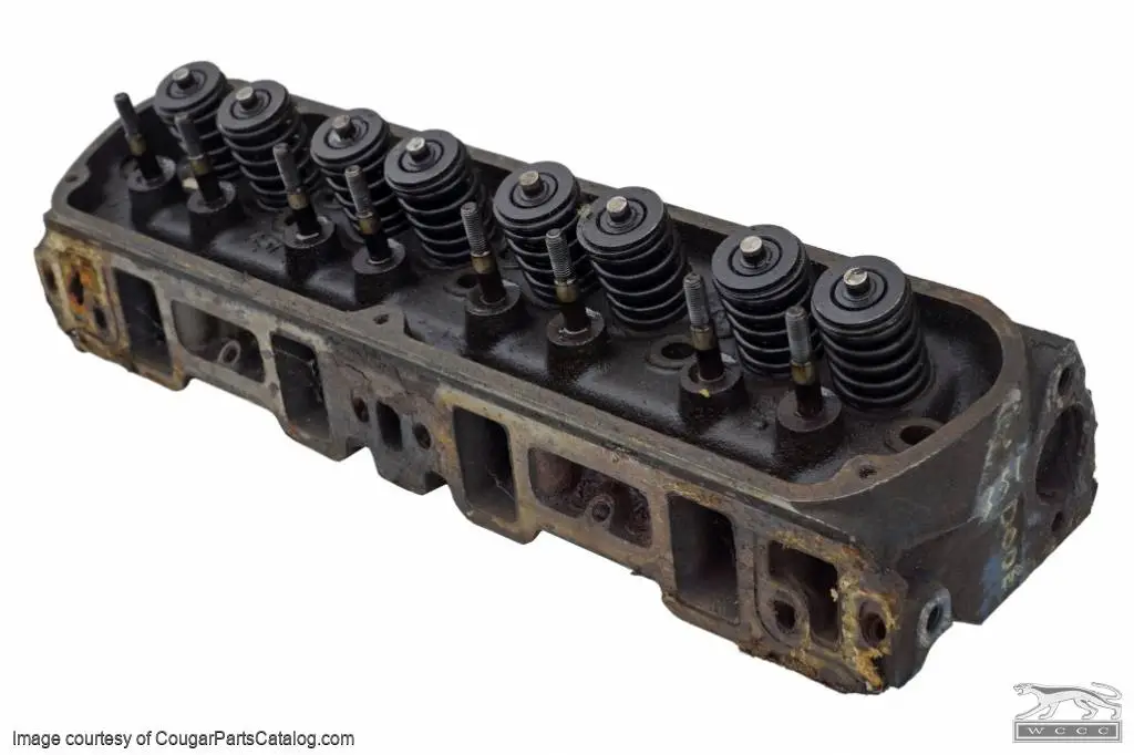

2Blue2 will be trying this sex one when I can find it Mod Dude Mar 5, 2019 4,052 2,693 163 Oahu Nov 8, 2020 #5 Nov 8, 2020 #5 universal fit for all small ford stock 69-70 351w head has the port that way
93 teal terror Founding Member Jul 13, 2001 971 62 69 Durham N.C. Nov 8, 2020 #6 Nov 8, 2020 #6 Awesome thanks. I guess I can just cut it out?
General karthief wonder how much it would cost to ship you a pair Mod Dude Aug 25, 2016 25,529 9,686 203 polk county florida Nov 8, 2020 #7 Nov 8, 2020 #7 I wouldn't, I would get the correct gasket but that's me.

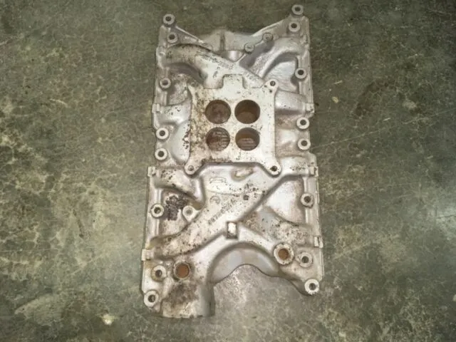

7991LXnSHO wanna catch the space herp 10 Year Member Sep 1, 2010 7,388 3,099 194 Kearney, NE Nov 8, 2020 #8 Nov 8, 2020 #8 2Blue2 said: universal fit for all small ford stock 69-70 351w head has the port that way Click to expand... Bonus point question: what’s that extra hole or port for?
2Blue2 will be trying this sex one when I can find it Mod Dude Mar 5, 2019 4,052 2,693 163 Oahu Nov 9, 2020 #9 Nov 9, 2020 #9 Beer! Reactions: 1 user
7991LXnSHO wanna catch the space herp 10 Year Member Sep 1, 2010 7,388 3,099 194 Kearney, NE Nov 9, 2020 #10 Nov 9, 2020 #10 2Blue2 said: Beer! Click to expand... 180 to 230 degree beer run through the rusty iron of a pick up engine does not sound very good.
2Blue2 will be trying this sex one when I can find it Mod Dude Mar 5, 2019 4,052 2,693 163 Oahu Nov 9, 2020 #11 Nov 9, 2020 #11 That the temps distilled alcohol occurs at right?
2Blue2 will be trying this sex one when I can find it Mod Dude Mar 5, 2019 4,052 2,693 163 Oahu Nov 9, 2020 #12 Nov 9, 2020 #12 I dont know of course maybe extra bolt for leak fixin'
Mustang5L5 That is…until I whipped out my Bissell Mod Dude Feb 18, 2001 41,729 17,325 224 Massachusetts Nov 9, 2020 #13 Nov 9, 2020 #13 7991LXnSHO said: Bonus point question: what’s that extra hole or port for? Click to expand... 16-bolt manifold with extra intake manifold bolts around the coolant passages Reactions: 2 users
