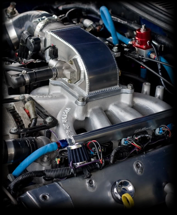

    You really need to do a proper upper elbow like this for the Edelbrock intake:
    [IMG]
    He sells them dirt cheap for the amount of labor needed to make it IMHO.
    Wait on the cams, you need bigger ones for sure. I will have my Stage 3.5 NPI together with a Logan intake in the next few months. Then we can see what the powerband really is.
