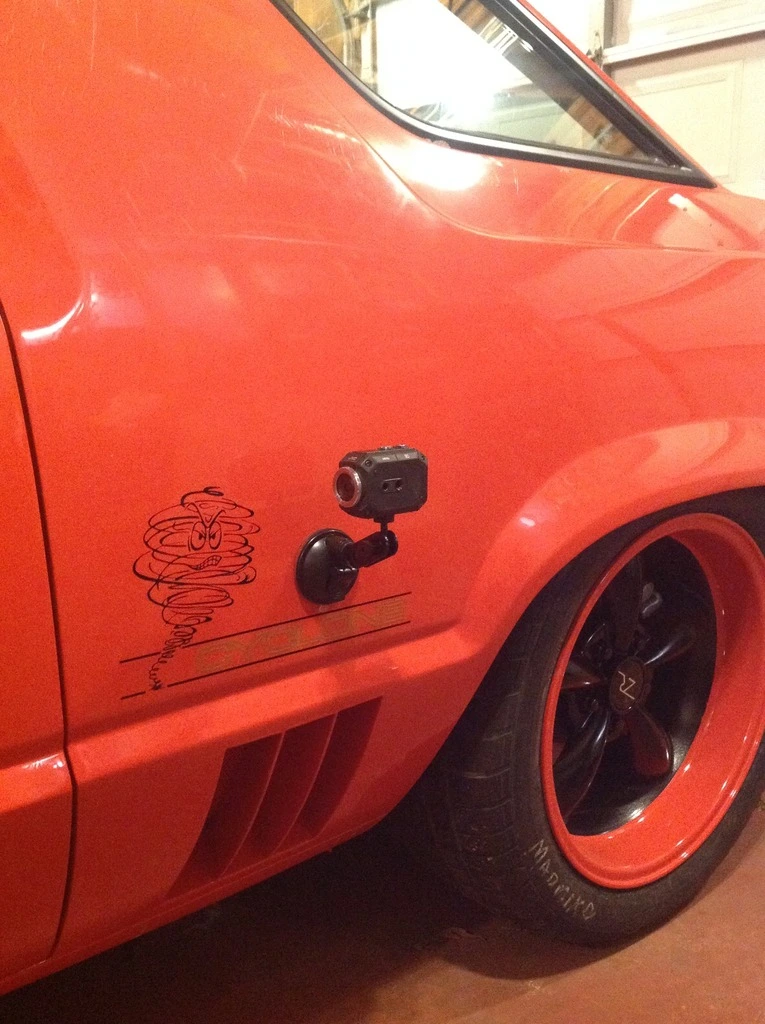

@RaggedGT recommendation for a camera mount for the roof and body,...I now have a way to strap that dude safely for a ride along on both the inside and the outside of the car.

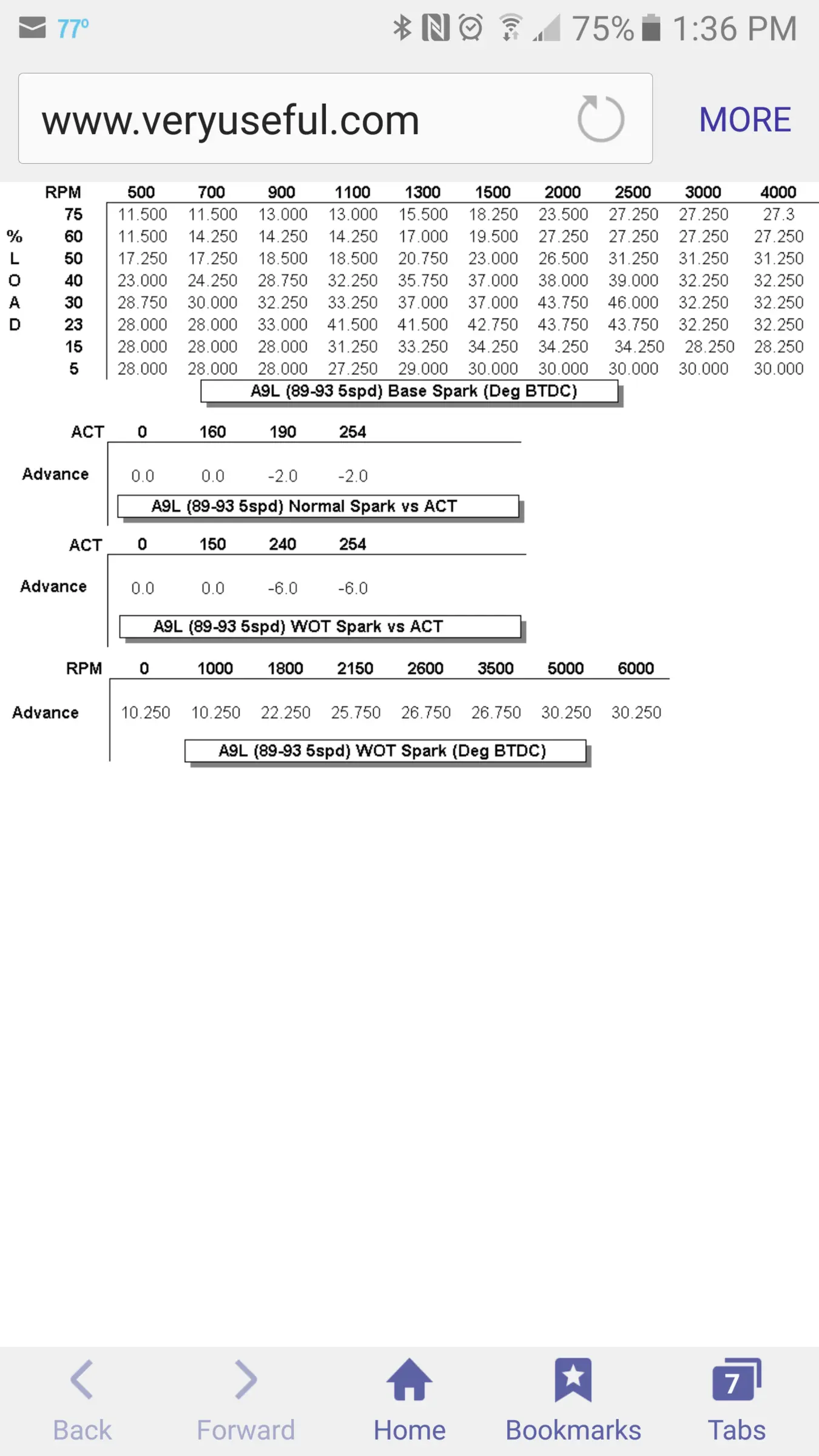

I can't write computer code,...which coincidently seems a little like trying to tune the car,..so yeah...
We are gonna have to go over a few things on the tune.
