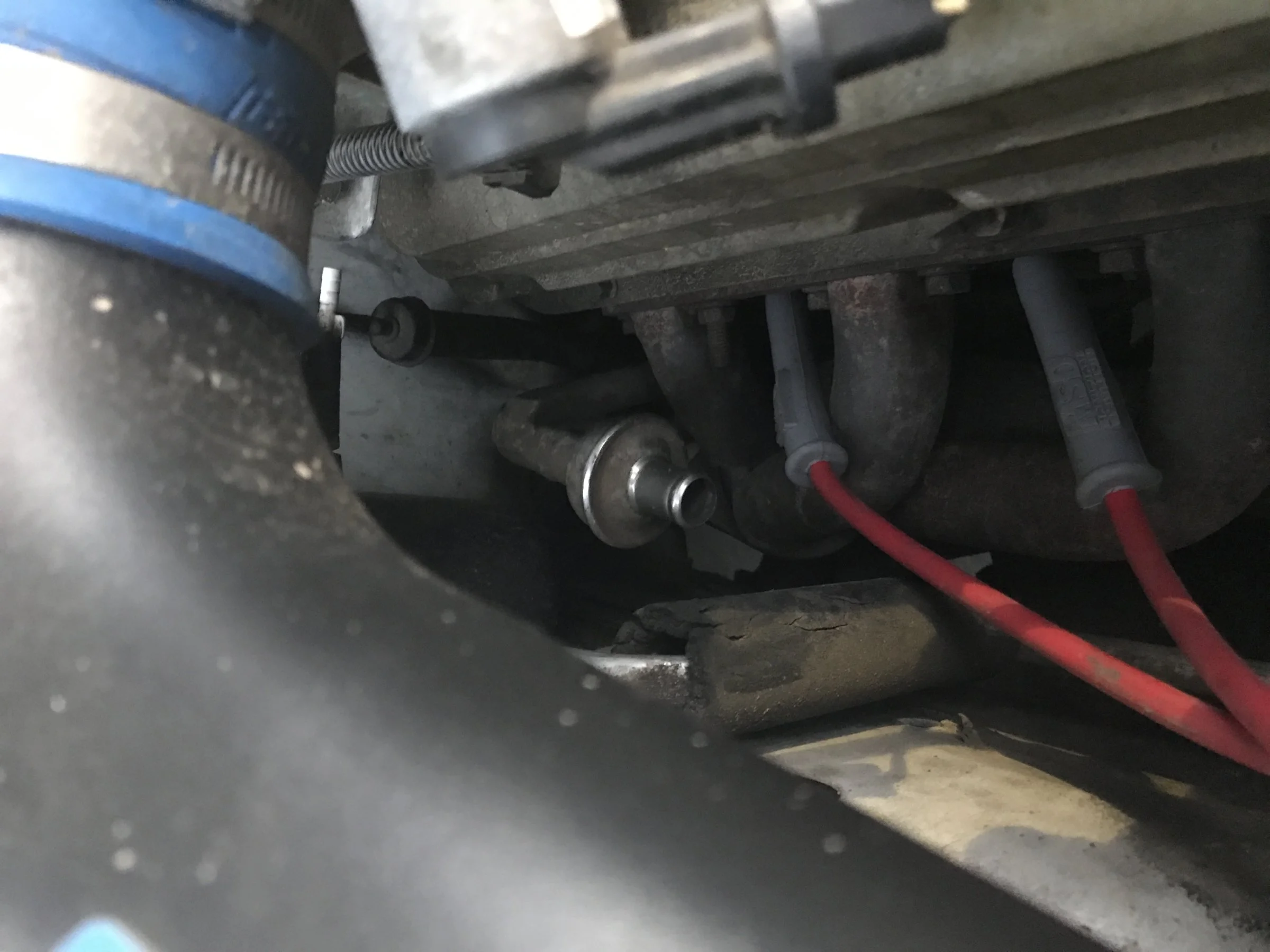

Am I suppose to remove this or plug it up?
You need to plug that up or remove it and then plug it at the H pipe. However, if you are going to delete the air pump, you need to remove your cat'd H pipe and replace with an "offroad" h or x pipe. Others will also replace the stock cats with some Magnaflow high flow cats that do not require an air pump and helps with a smelly exhaust.

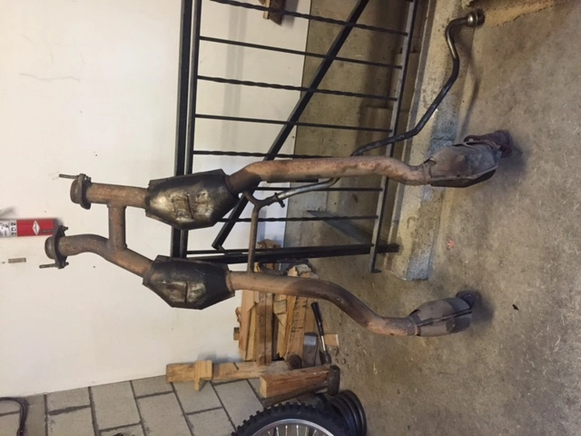

Below is the pipe I am talking about that provides air from the pump to your cats.

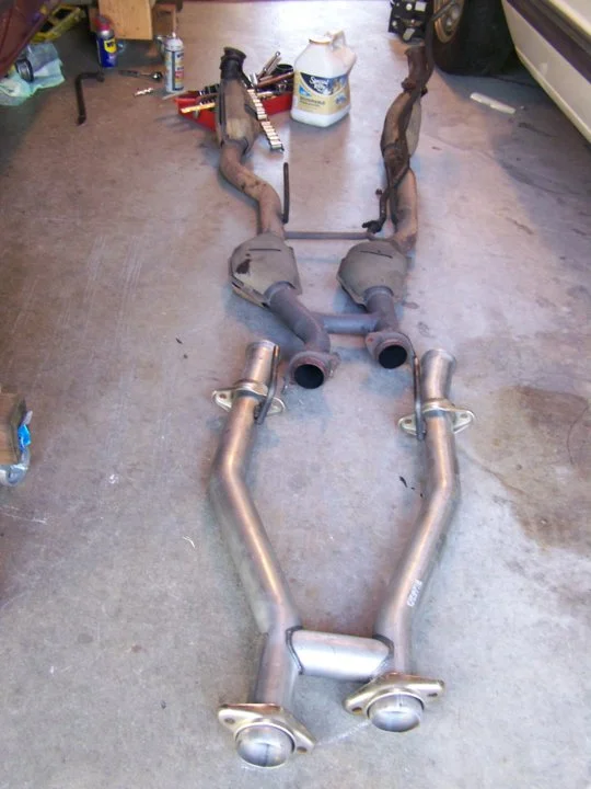

My old stock cat'd pipe and my new cat'less H pipe. This is from when I deleted my smog pump.

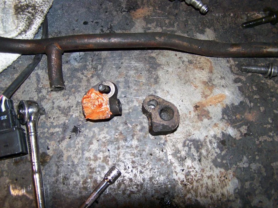

Below is the pipe from the back of your heads that you need to remove, cut off the peices, and reinstall on opposite sides that you removed with some copper RTV.
