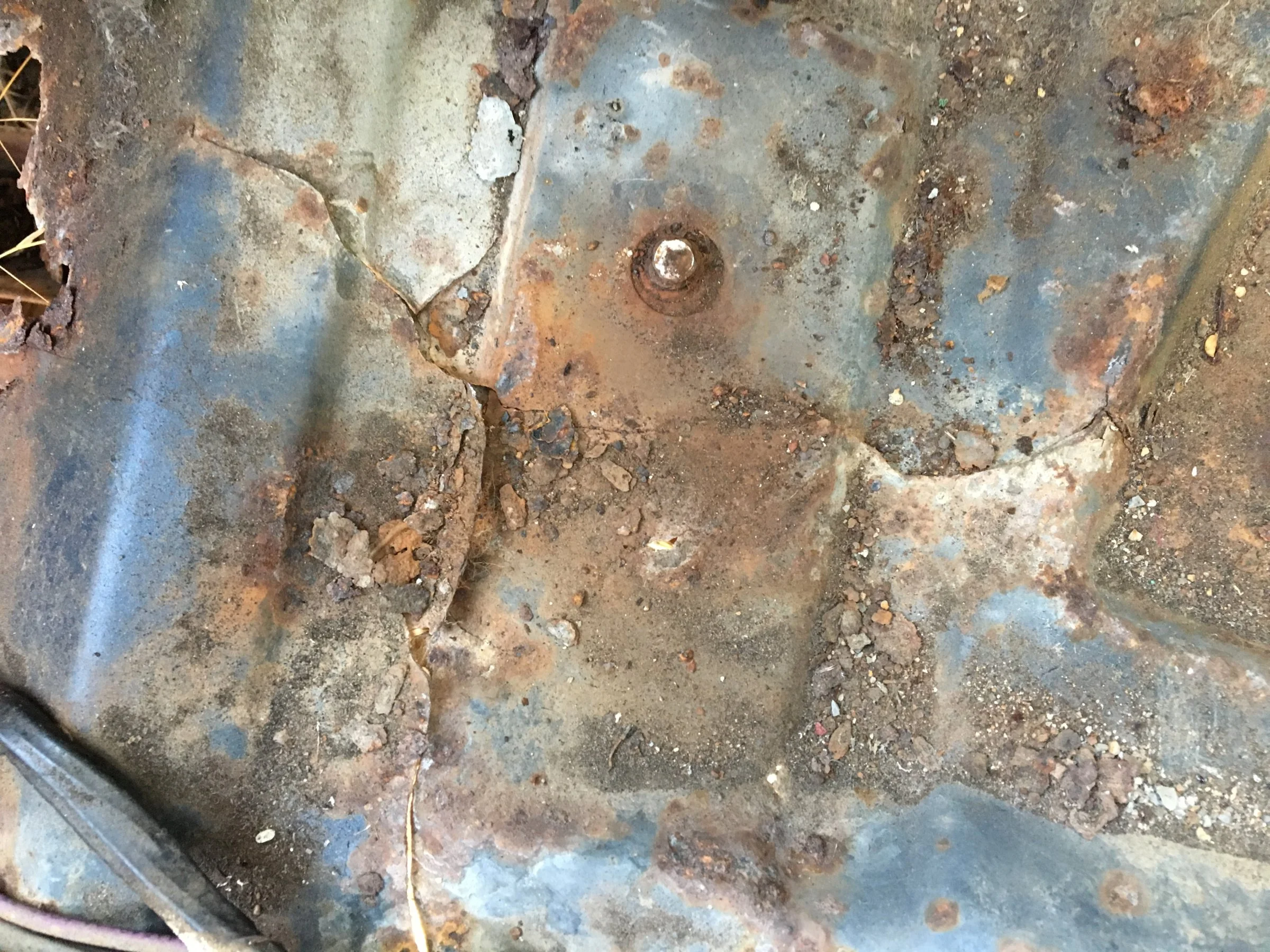

Even matching the floorpans gauge isn't always the best. Here's a picture of my driver's side rear, notice the cracks in the floorboard.
This wasn't caused by excessive acceleration from the PO (it's a V6), more like excessive double quarter pounders with cheese and large fries. I would recommend an extra plate in that area, if you already are replacing the pans. Just in case of an overly large in-law drops their full weight on your poor mustang. Take a look at these from LMR, I'll be putting them on both sides of my blue car.

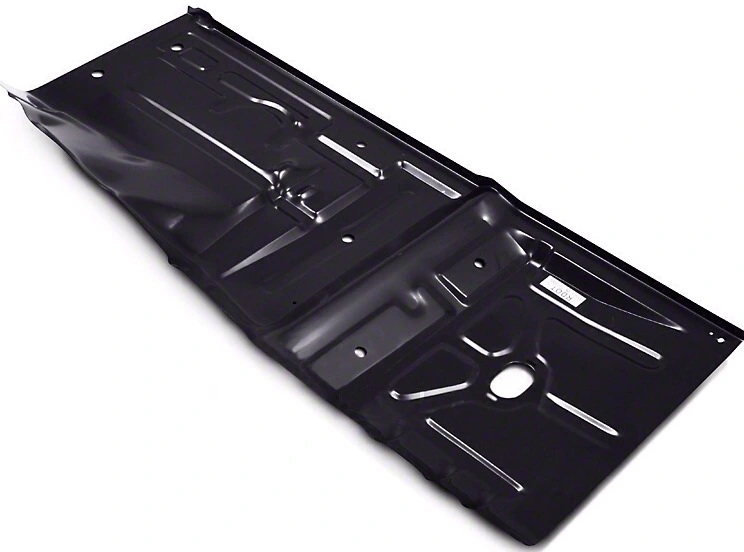

https://lmr.com/item/LRS-11135RP/79-93-Mustang-Floor-Pan-Reinforcement-Panel
