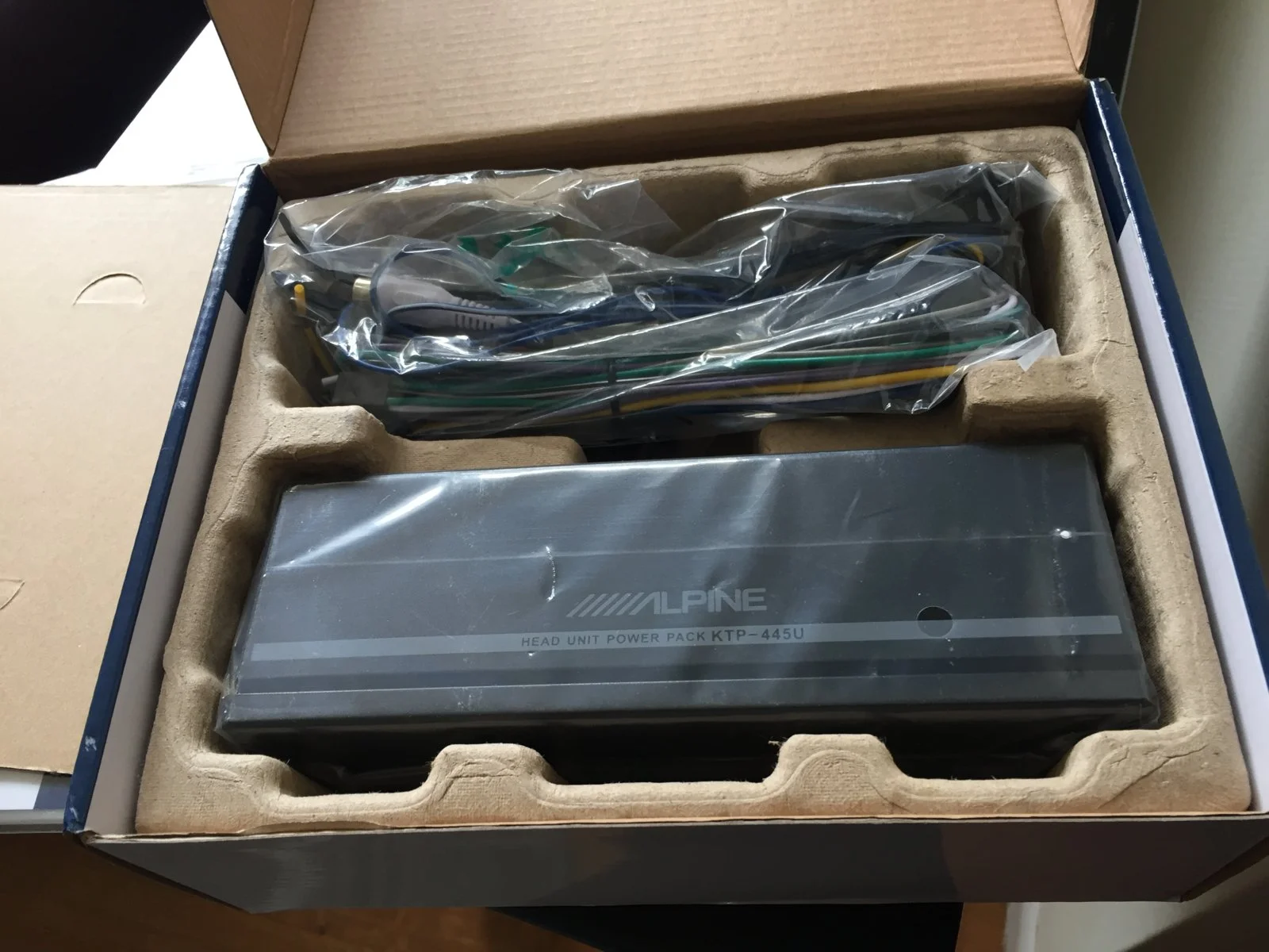

I actually bought one. Going to try to use it with my 93 CD player.
Problem is to make it plug and play I think I need to find a donor car to snip the wires into the factory head unit off, solder to the alpine kit and then use a metra harness to connect to speakers.
Should give me 45 watts per channel vs current 20 with the oem amp
Worth a shot

Bypass. You are pretty much doubling the power output with this modern amp.
If/when i install it, i'll def post something but my install will be a little unique because 1993 stereos are wired a bit differently than 87-92. I know you however do have a '93

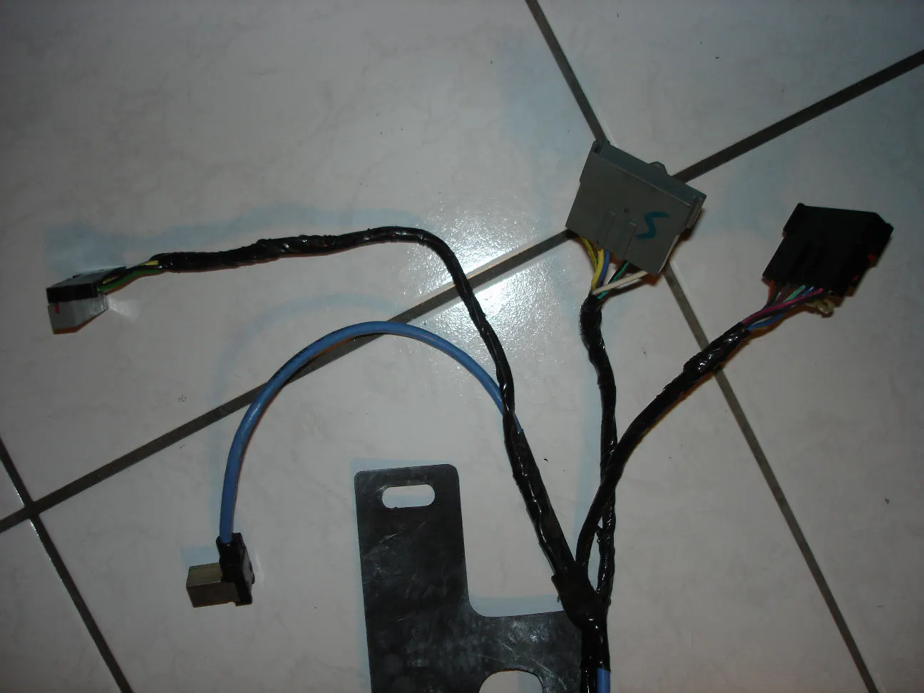

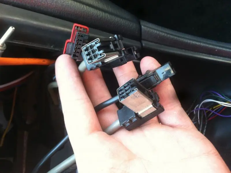

Metra 70-5511 is the correct kit for the 93 radio using the OEM amp, but it's also a female plug.
Basically need to find this blue wire. It's the 8-pin speaker out wire from the stock head unit to the amp
I believe the metra 70-1770 can be used for the two plugs on the right that output to the speakers. You can probably use one harness from the 71-1770 kit for the left power harness to the head unit. Just need to track down that blue wire...probably by hacking up an 94-00 Mustang at the boneyard for it.
