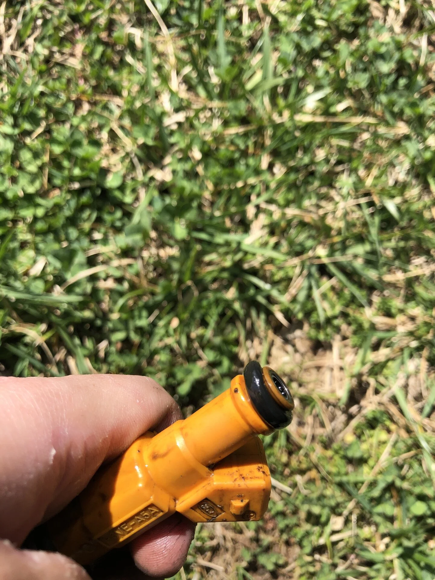

Well I found the culprit
The O ring was all bent out of shape. I replaced a few of the upper o rings and put them in the rail then put them in the intake carefully. About to prime the fuel pump a few good times before I throw the upper back on. I disconnected the feed line to the rail to give me leverage on that side only and broke my little plastic tool. RIP harbor freight quick disconnect
