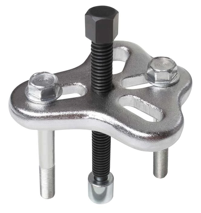

I guess I've been lucky. Mine is very easy to remove. I use a small cordless 1/4" impact driver and this puller.
Maybe it’s timeTried the puller again with new bolts and the right side keeps stripping out whenever I tighten the middle. So frustrating!! I might bring it to a shop.

When you remove the cover, there will be two holes that a puller bolts into. The threaded insert on the puller threads through the puller. Once threaded through the puller, you place the provided pivot end on the puller that threads against the main shaft that you removed the nut off of. Then you start to tighten down the threaded insert. That action will force the steering wheel to pull off of the shaft.

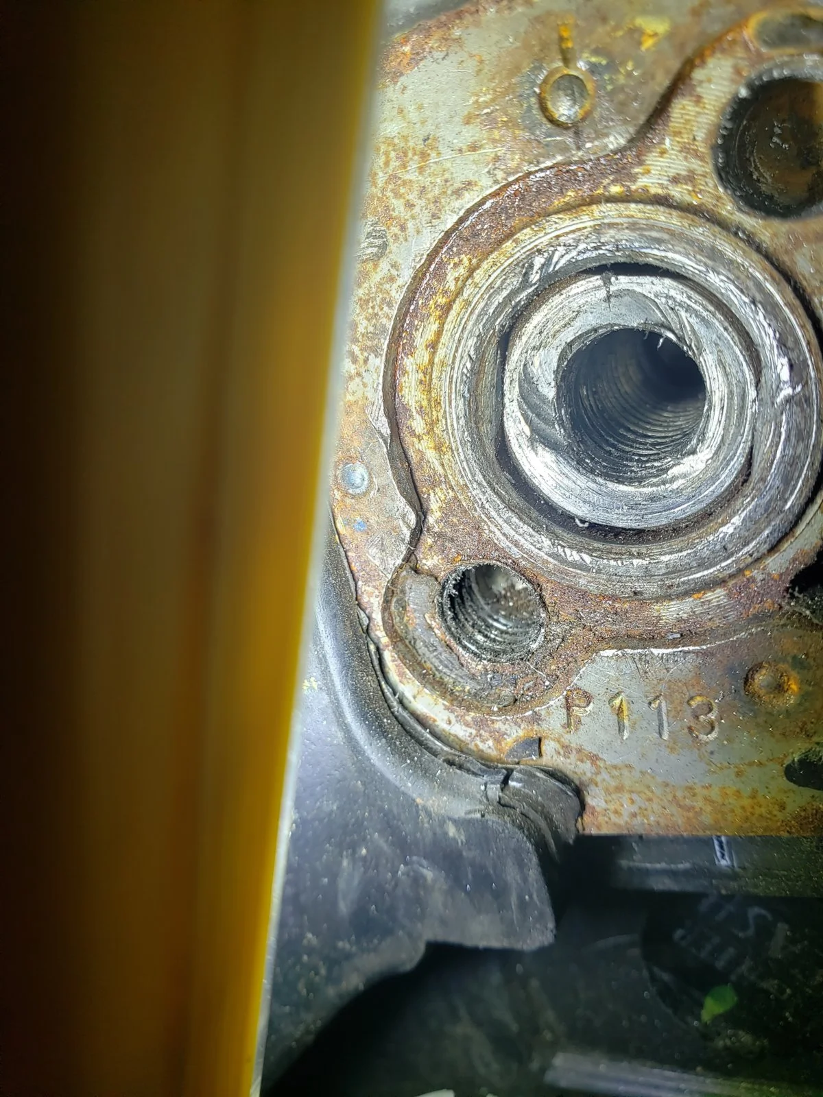

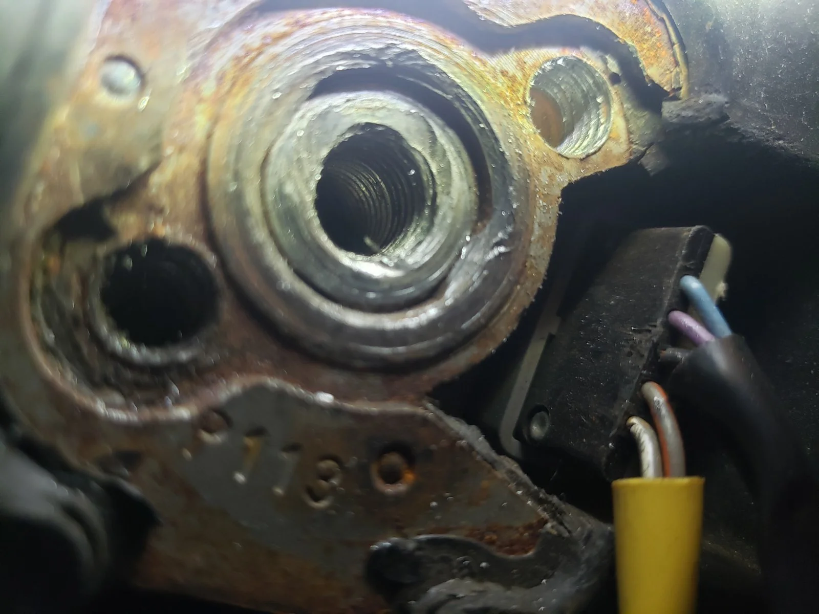

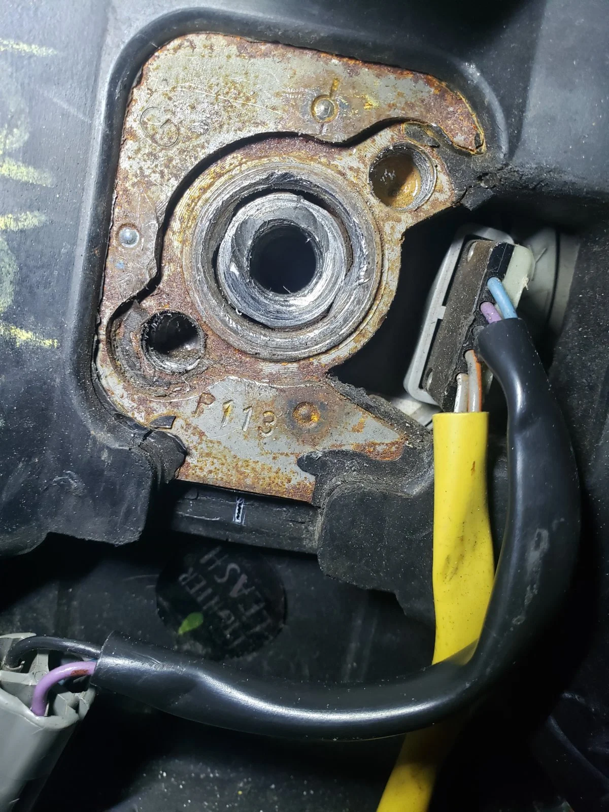

Heres some pics of the wheel. I am most likely bringing it to a shop to remove it.
In the pics it kinda looks like the metal of the steering wheel around the end of the steering shaft is boogered up. Make sure that the center bolt of the puller is not hitting the steering wheel. If that happens then you are pulling and pushing on the wheel at the same time. It will never come off like that. I've had those pullers bend before. If you're not lined up straight it will start to bend. Once it does that the bolts are toast. The metal might just be marked up from puller walking around as you turn it. Does the puller you are using have an end with a point or is it flat? The point goes in the middle of the steering shaft to keep it from moving. At least that how the ones I've used worked! Good luck!
When I use a steering wheel puller I thread the bolt in the center hole a few turns and blade the puller on the bolt head.
You're beyond that now. That screw hole is stripped. Some penetrating oil like wd40 or PBblaster may help loosen it. Just spray it and let it sit for a while. Put the bolt in until it is about a 16th to a 1/4 inch gap. Put some plastic ( like plastic bag plastic ) over the bolt head and stick the socket on it. Now....pull on the wheel with one hand and smack the socket with a hammer with the other hand. A few good smacks should get it off.
