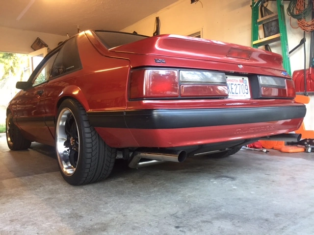

Did you ever get your wheels on the IRS setup? I'm curious what you did with the fenders out back. My 18x9s w/ 275 rubber hit bad.

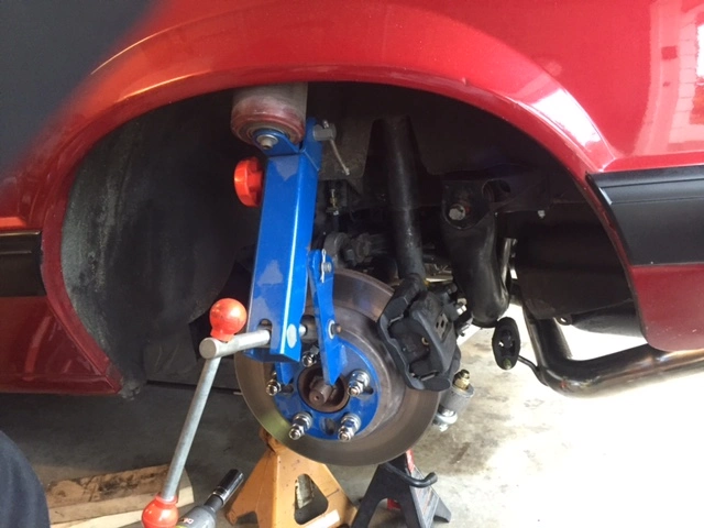

I rolled my fenders like this
I then added some neg camber to tuck the tops of the tires inside the wheel well
I have a different offset and tire width than you. I have 18x9 +35mm out back with 245 wide tires. I could go a little wider and I just might do that, not sure when though. The twin screw supercharger is, surprise surprise, causing traction issues.
Yeah. I went and bought one of those tools. I just haven't had a chance to get out there and mess with it. How hot did you have to heat up the fender lip to avoid damaging the paint?
I got it pretty hot but not as hot as possible. I bought a heat gun from Harbor Freight for about $15 that has low heat (572*) and high heat (1,112*) and worked well. I used only the low heat setting.
https://www.harborfreight.com/1500-watt-dual-temperature-heat-gun-5721112-62340.html
Reactions: stangboy
With an IRS it's all about the wheel offset/back spacing. Mine is an 18x9 with a 6.72" BS (+45 offset I think) with no rubbing and a 275 tire. I do have some fairly stiff springs, and some half ass rolled fenders as I didn't have the right tool but the paint is such crap it didn't matter yet.
Reactions: 90sickfox
Too few wheels at 9"/+45mm and most of them look like crap on our cars unfortunately. If you're willing to pay TF money then a lot of doors open for nice wheels but I'm not going to invest that kind of money into wheels. Just last week I found a wheel that I think will look great on my car and is 17x9 +45mm but I like to look at the wheels for a while to see if I still like them after a while and if I do then I'll order them. 18's are nice but I'll go back to 17's so I can fit a 275 out back again without issue.
I'd be fine with 17's, but to be honest at this point given how much we sink into these things anyways, I'll just save up for the custom wheels in the right sizes... the biggest problem is what you mentioned PLUS getting front wheels to fit right and match. They usually don't make them in the proper offset up front so you've got to run a spacer which I hate. I'll bite the bullet one day, I always do.
