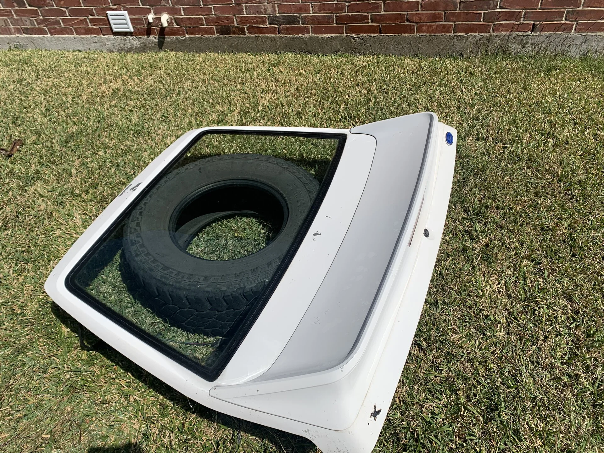

Over the past year and a half, I've bought four hatches. The first one had a little rust, and I thought I could do better, so I bought another and found it had hidden rust. I finally found one that had no rust...but it turns out it had been hit and repaired with plastic filler. About two weeks ago I found one that still had the original paint on it and no rust, and it's going on my Fox. They come up all the time, and you just have to keep looking.I've been searing for a rust free hatch to replace mine with and couldn't find anything local to me. Found a guy who has some parts cars about 4.5 hours away but only has LX hatch's. How many holes will need to be filled if I go with the LX hatch on my GT? He wants $200 for the hatch.
May as well just flip it over and unbolt that spoiler, and then you’ll know. Looks like it’s in pretty good shape.Trying to find a rust free one where I live is very difficult. Lots of rust here. I’ve been searching for one within driving distance for a while with no luck so picked up this LX one. I just need to find out how many holes will need to be filled to use my GT spoiler.
There are nine holes under the LX spoiler, eleven if you count the two screw holes on the tips of the spoiler. I did find one '87-'93 GT spoiler and had the opposite problem of converting it to the LX spoiler which was on the '86 GT. But that was the hatch with the body filler and it got scrapped.Trying to find a rust free one where I live is very difficult. Lots of rust here. I’ve been searching for one within driving distance for a while with no luck so picked up this LX one. I just need to find out how many holes will need to be filled to use my GT spoiler.

That’s a ridiculous amount of holes. The GT spoiler needs only 4 bolts to stay on. I did not pull the hatch panel and check my LX until I had already bought a nice GT spoiler.There are nine holes under the LX spoiler, eleven if you count the two screw holes on the tips of the spoiler. I did find one '87-'93 GT spoiler and had the opposite problem of converting it to the LX spoiler which was on the '86 GT. But that was the hatch with the body filler and it got scrapped.
