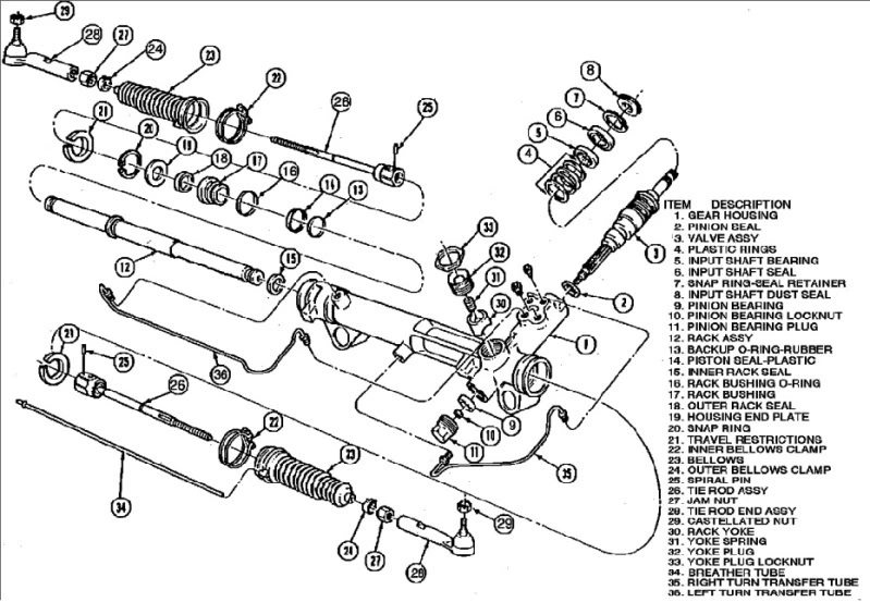

The two inner tie rod ends are usually what wears out, and at $45 each, it's better to get a replacement rack assembly since they are part of the package. The rack is about $100 + a $40 refundable core charge, which you get back when you return the old rack. Be sure to ask for the GT or high performance rack, it has fewer turns lock to lock than the standard rack.
The flex coupling for the steering shaft needs to be disconnected before you can get the rack out. You should disassemble the coupling by removing the 2 bolts that hold it together. The lower part of the coupling will then come out with the rack, and can easily be removed.
