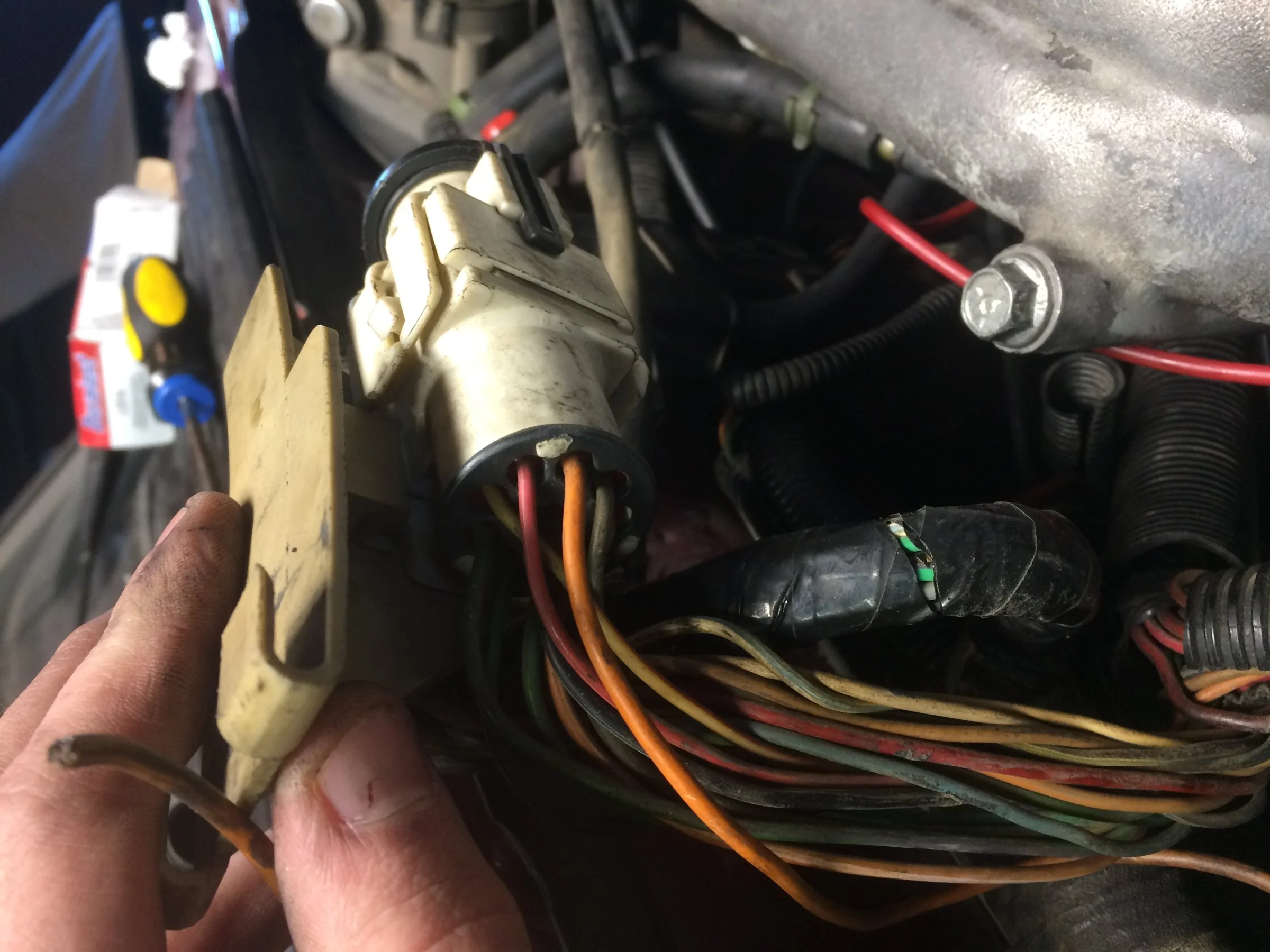

The orange wire is the O2 sensor heater ground - very important for proper function of the O2 sensors. It will not prevent the engine from starting..
Here where you need to spend your time troubleshooting...
