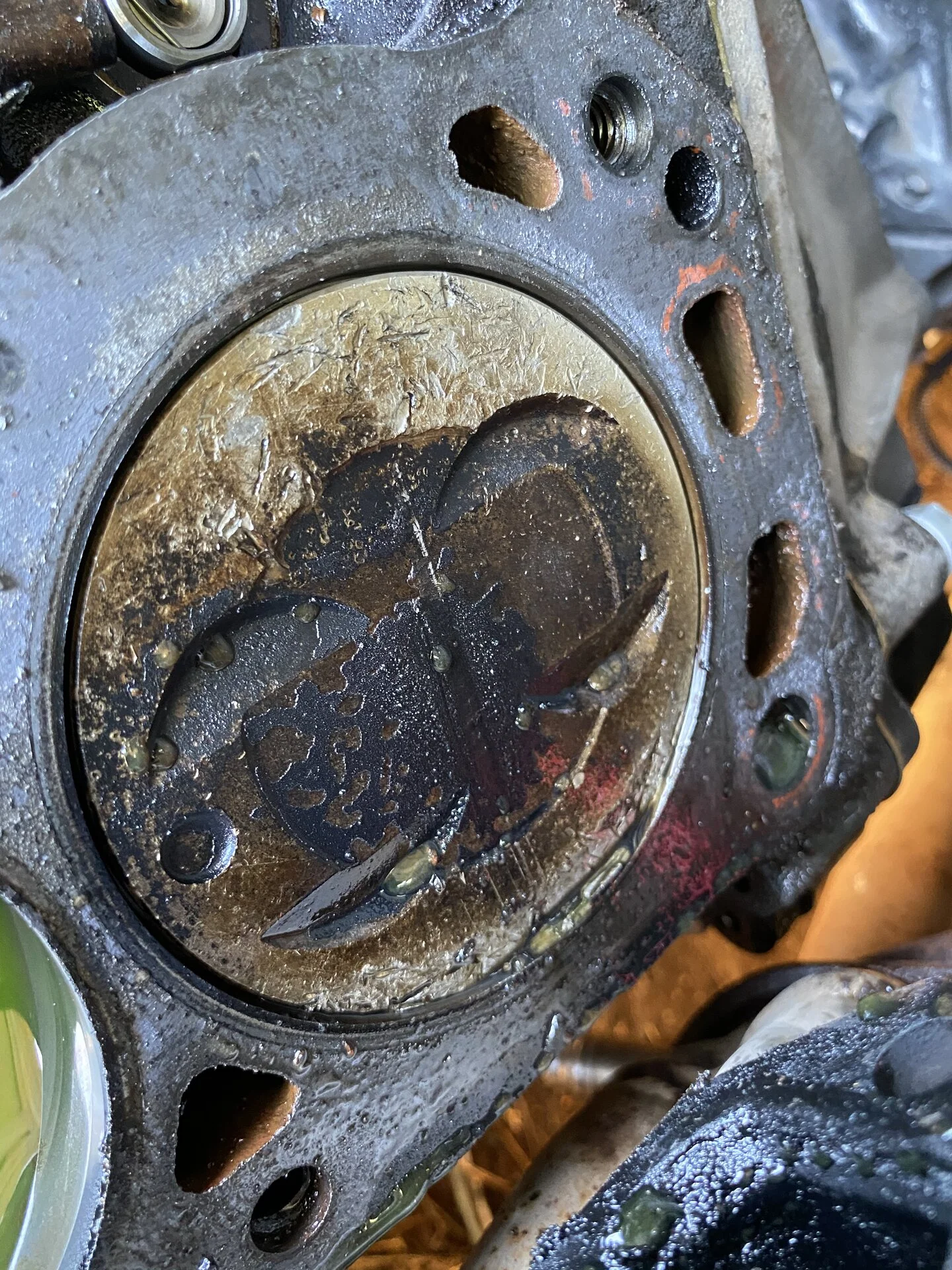

Finally pulled the heads off to address my oil burning issue and piston #8 looks like this. Need a new piston or can this one be fixed?
Dude I found a damn valve guide in there LOL previous owner was on something.What was loose in there? How do the head and valves look? If the bore is scored from the shrapnel that did this, you will need more than a new piston and three rings.
(I am putting money on a loose spark plug electrode.)
Also the valves on cylinder 8 are totally black from oil the car has been burning since I got it.What was loose in there? How do the head and valves look? If the bore is scored from the shrapnel that did this, you will need more than a new piston and three rings.
If it had aluminum heads, they would need at least touch up. I’m curious to see how cast iron did against the valve guide. IMO a cast or hyper piston that looks like that is waiting to blow chunks.Also the valves on cylinder 8 are totally black from oil the car has been burning since I got it.
