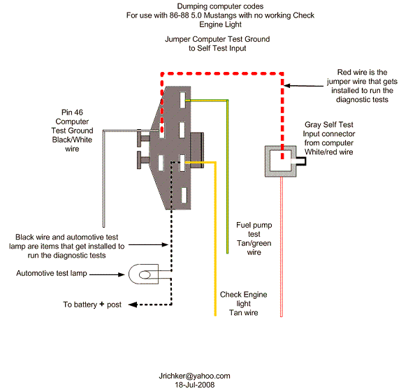

The following is a view from the computer side of the computer wiring connector: it is for an A9L, A9P computer.
Check out the diagram and notice all the places the black/white wire goes. Almost every sensor on the engine except the MAF is connected to it.
See the following website for some help from Tmoss (diagram designer) & Stang&2Birds
(website host) for help on 88-95 wiring
http://www.veryuseful.com/mustang/tech/engine
See the graphic for the 10 pin connector circuit layout.
