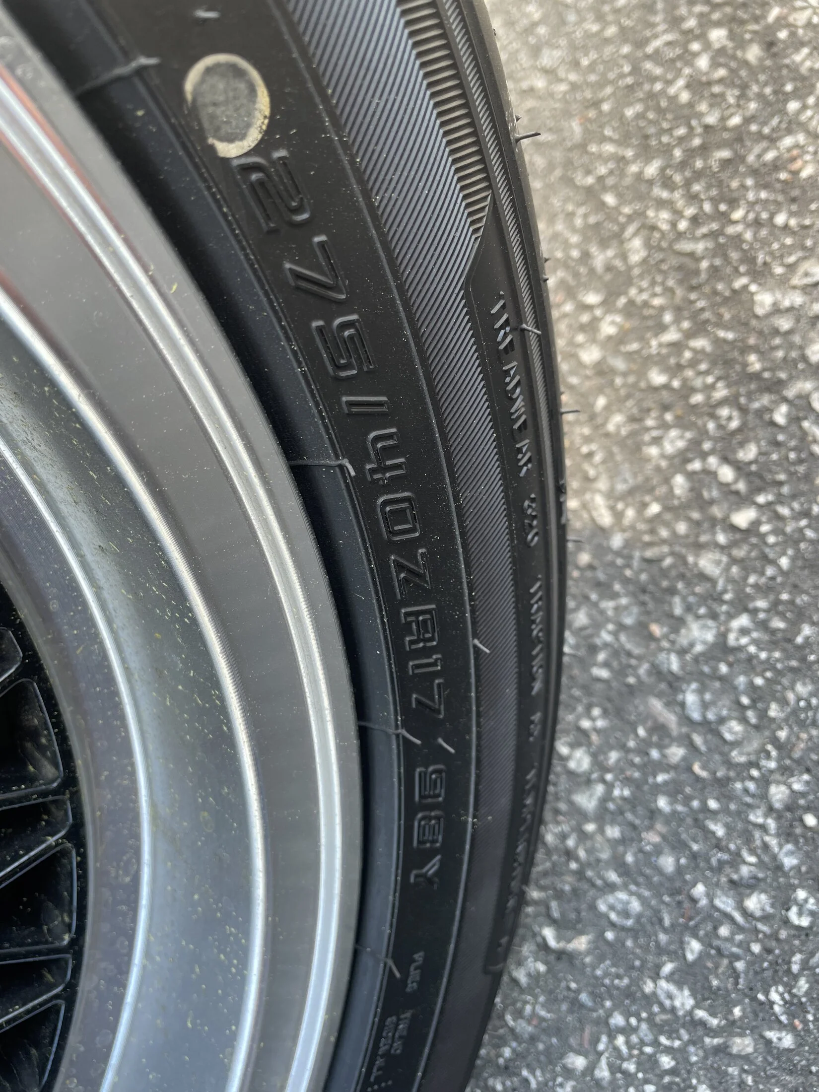

Correct. A 275/40/17 tire should be around 25.7" in OD. You'll have to look up the brand specs to get a more accurate number as there is some variation between manufacturers.
Any pics of your wheel/tires? Wondering if they are rubber band tires.....

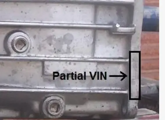

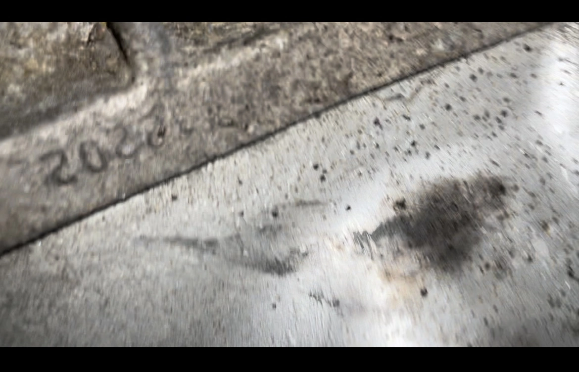

also your 1352-065-904 is a 83-84 v 8 non world class t 5.
Also, If you do not know how many teeth are on the speedo drive gear (the one on the output shaft of the T5) then you are guessing in the dark as to what driven speedo gear (one on the end of the VSS).
