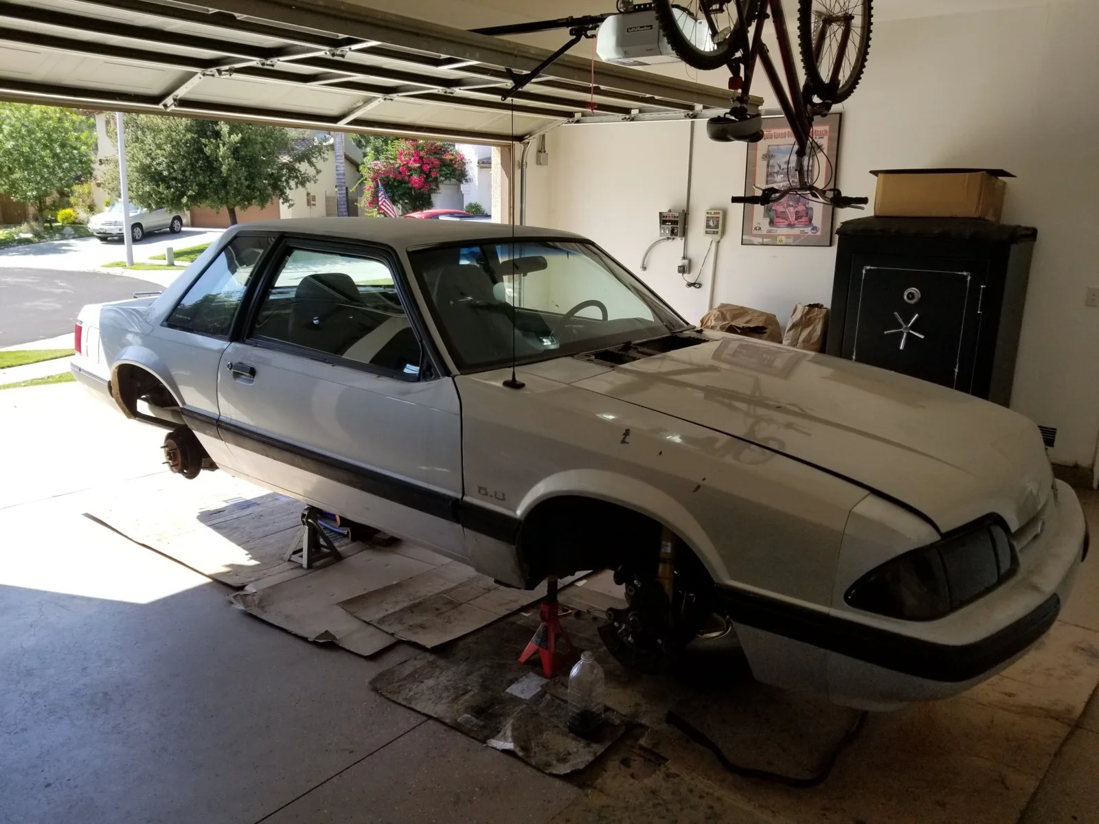

Welcome to my progress thread. What you are about to view was at one time a restoration, but has now evolved into an overall performance upgrade being done to a 12 owner original 4 cylinder auto trans equipped '93 Mustang. An ongoing process of restoration where the idea was to pay homage to the venerable Fox Body platform, but also give it a bit of an upgrade. New Terminator brakes and steering rack, but retain the live axle. Add cupholders and horsepower and torque, and top it off with a T-56 six speed. Why? Because the small block Ford with the unique exhaust tone, buttery smooth tranny shifts and clean notchback lines are what make this car great. I'm just improving what's already here.

A work in progress
