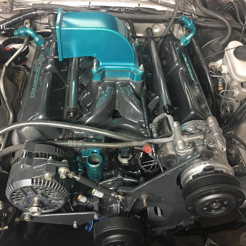

Pequena progress
Did you powder coat your alternator? If so how’d you go about that?
Hmm is it really that easy? Do you just unscrew it and pull out the innards? Idk why all that stuff inside it scares me like I’d ruin it. Tempted to buy a silver one then do the same
Yeah, it really is. Take the pulley off, take the plug on the back off, take the 3 bolts out, and slide it apart. Takes some wiggling but it’ll go.
