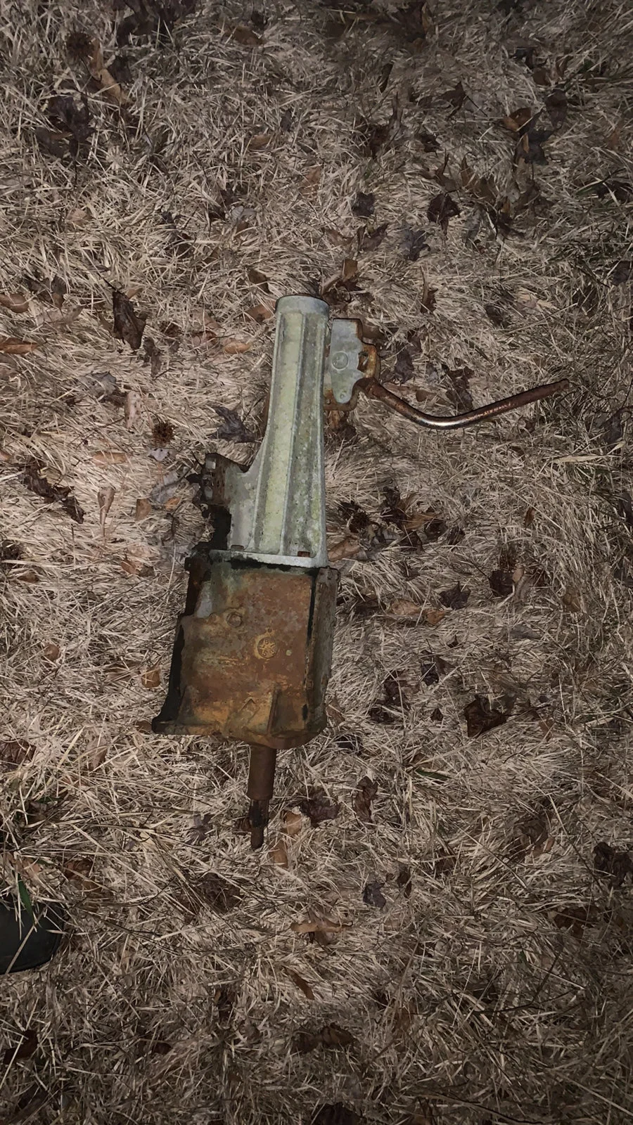

I don't see your tag number in the charts either (David Kee Toploaders)
3.03 is a great trans and for v8 ( I think 3.03 is distance between shafts in trans)
2.73 is a 6 cylinder trans.
25 spline input shaft (sucks, I bent/ twisted one drag racing on street tires) was discontinued early in 1965 and 28 spline 1-1/16 became standard for everything up to 390 light duty.
This trans was used in various forms behind big blocks and AMC as well.
Was also used for 3 on tree applications and with top cover shifter in some jeeps.
Yours looks to be passenger car type by shifter bolt on location.
