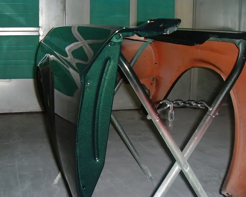

  1. Fenders are ready to be wet sanded and buffed after spraying 6 coats of SPI Universal clear.

  6. When you apply 6 coats of clear is it necessary to color sand any between coats? And how long after you spray on the epoxy primer can you wait before squirting on the color?

  8. Normally I would spray 3 coats than wet sand with 400 and apply 3 more coats of clear. Since this is getting stripes I sprayed 2 coats than will wet sand with 400 spray the white stripes than spray 4 coats of clear waiting about 30 min between coats.
    You can spray color 1 hour after spraying 1 coat of SPI epoxy. I sprayed 2 coats of reduced epoxy and waited until the next day and wet sanded with 800 (did not want any sand scratches to show since it was a metallic) than retaped the car and sprayed 4 coats of base than the next day 2 coats of clear.
