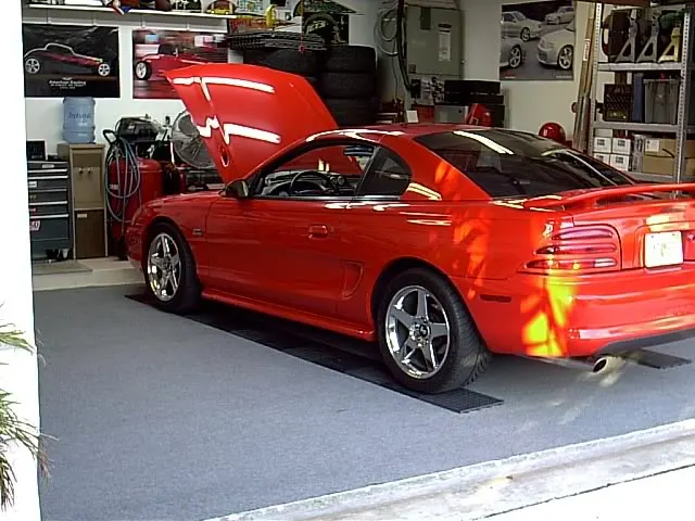

:nice: here is a nice pic showing off my 18" FR500's... may as well whore it up ;)
NICE WHEELS. CRISPY.
What r your tire sizes front and back??
