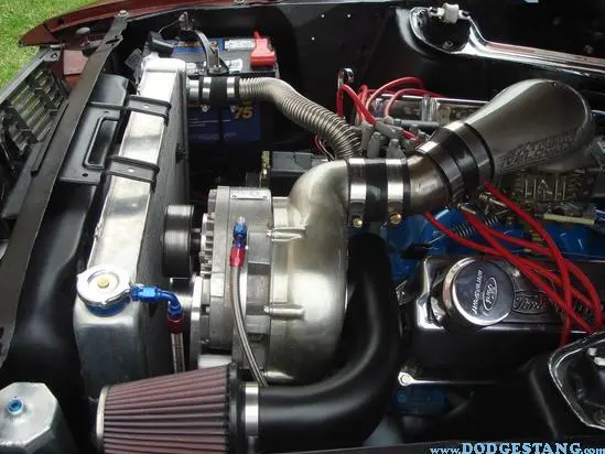

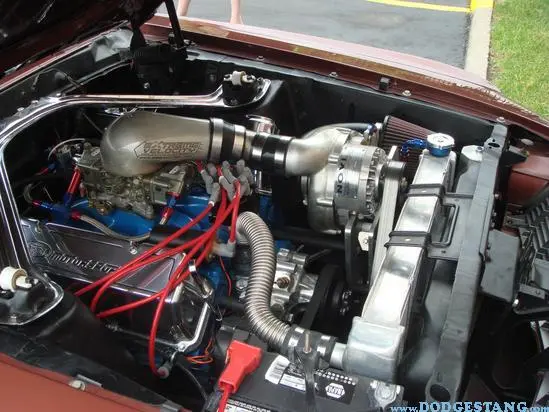

  16. Well this thread is an oldie but a goodie I suppose......You should only be interested if the brackets and setup look this nice when you are done ;)
