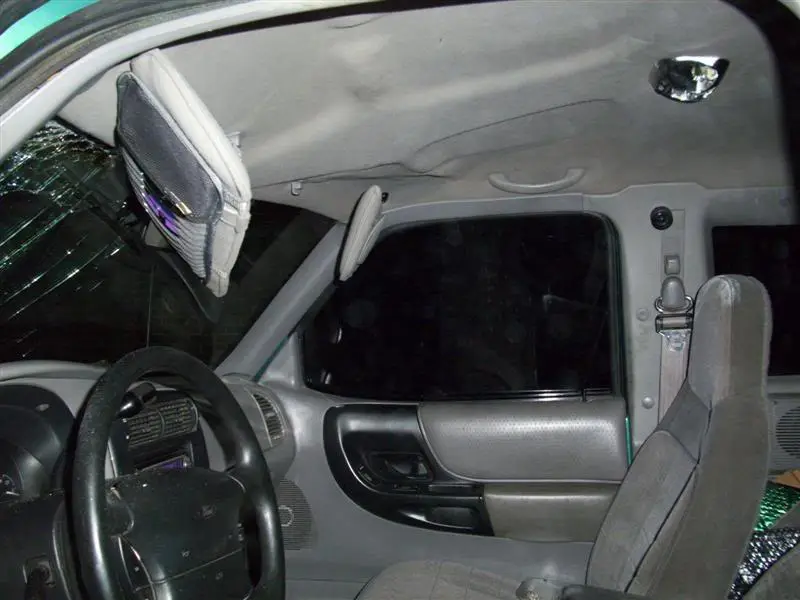

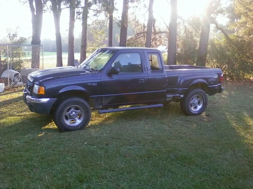

last week i picked up a 2001 ranger ext cab 4.0 auto 4WD that had the interior gutted but the rest of the truck is in great shape. got the truck for $500 with a title BTW!!!:D
now for the interesting parts. i plan on swapping the roof and windshield onto my 95. i sold the engine and trans to a buddy for $250. i will be swapping the entire front end from the 2001 onto my 95 and using the 8.8 from the 01 under my 95 also. i will be putting a spool in the 8.8 before it goes under the truck.

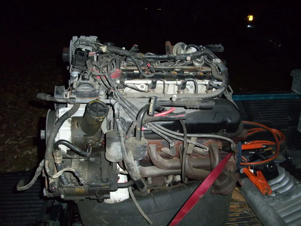

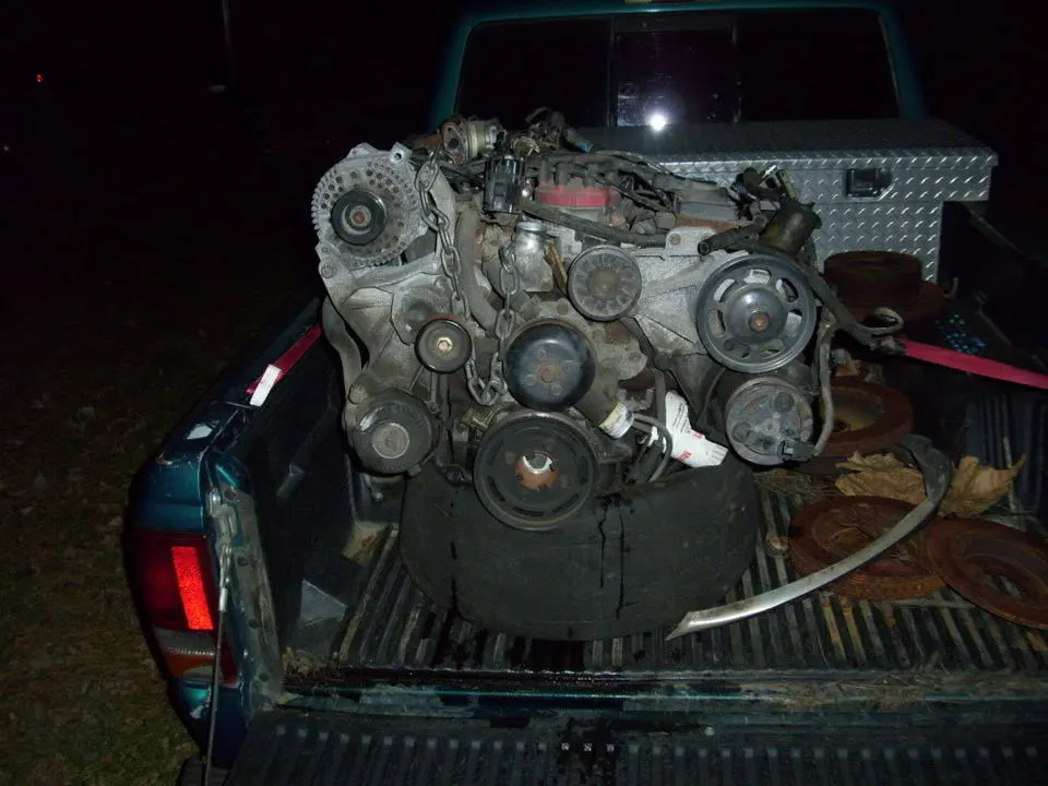

as far as the engine goes, i have a complete 302 from a 95 mustang GT complete from intake to oil pan with all accessories and flywheel included for $500. i plan on going with a carb setup for simplicity backed up with a built C4 i bought from a buddy.
plans for the engine are fairly simple. just getting the carb and dual plane intake, tossing in a F303 cam and adding a 150 plate system to make things interesting

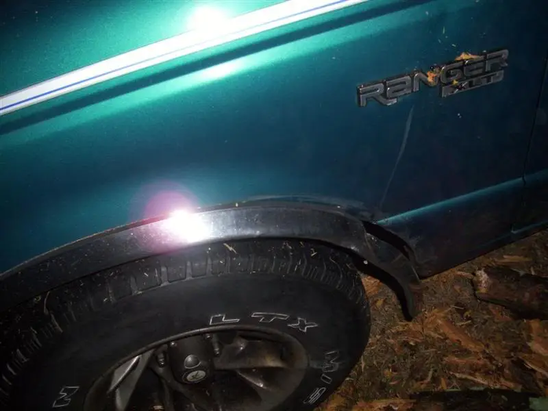

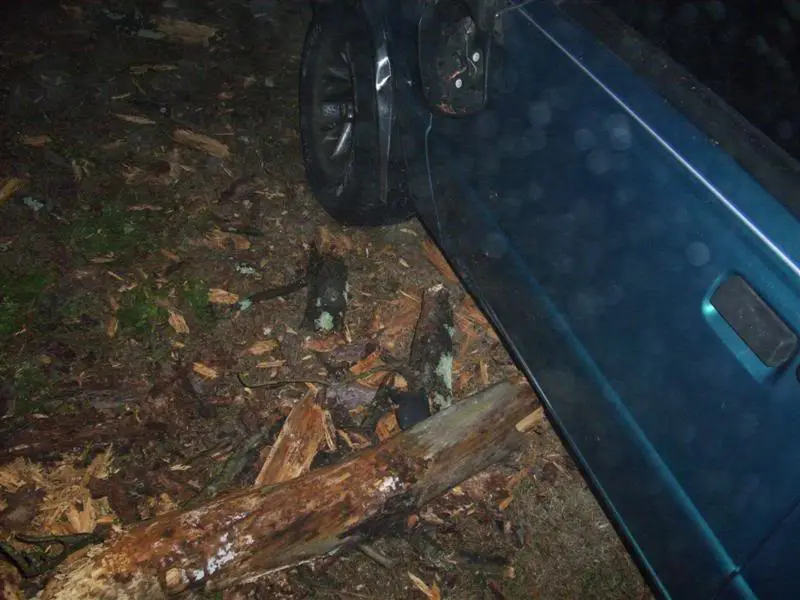

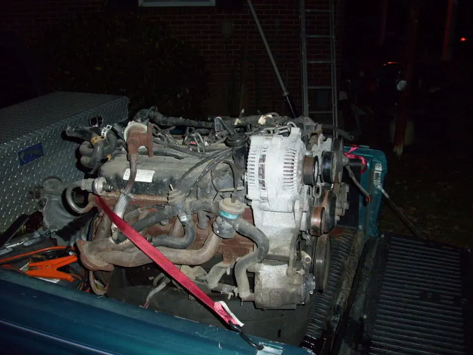

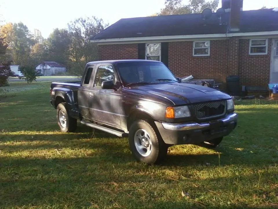

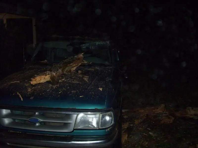

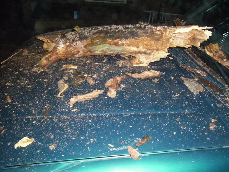

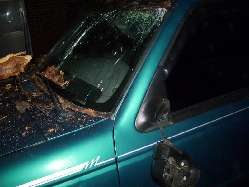

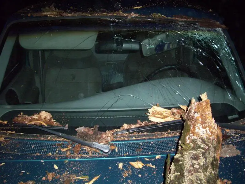

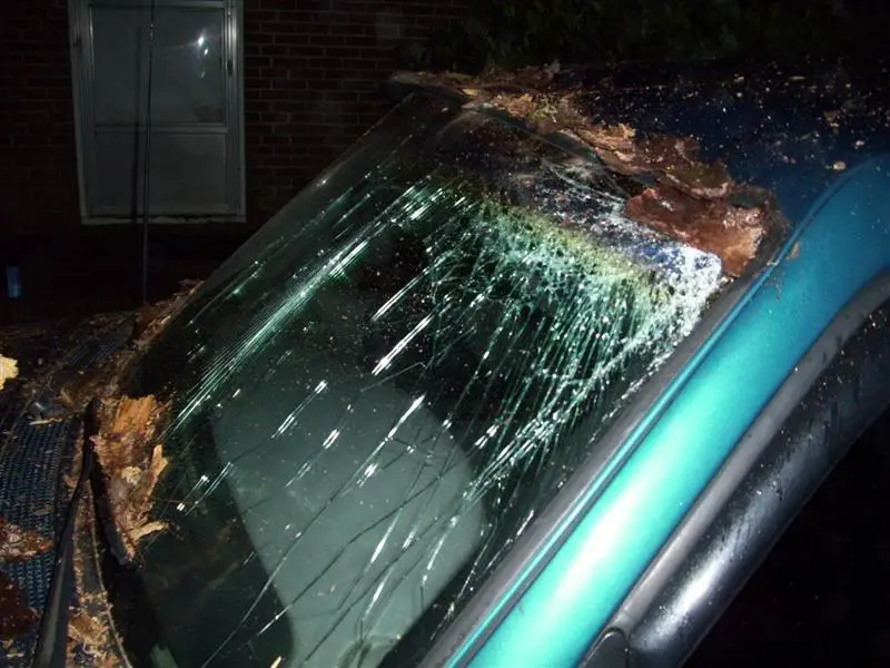

just for fun heres some pics of the 95 after the tree and a couple of the 2001 donor truck
i wont be able to tow with this setup. the trans is a C4 with a 3200 stall, reverse manual valve body and a trans brake. the truck has 4.10 gears so with the stall i dont think it would pull worth a damn.
