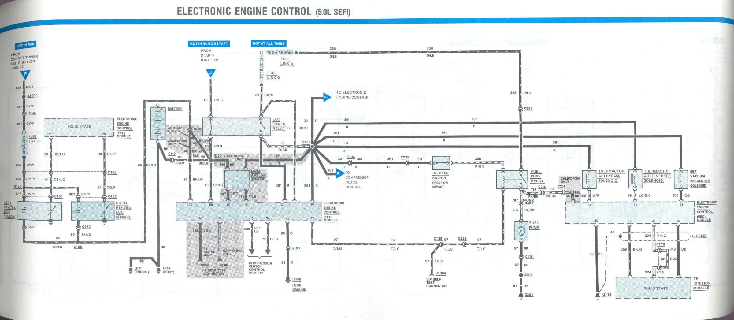

I am having strange issues with my 1987 lx. First I was not getting any power to my fuel pump, in diagnosing this I realized the computer did not have power either. The wiring harness was a little hacked and what I believe to be the EEC power wire (blue fusible link) was not connected. Without this cable connected I am getting a click in the EEC relay but nothing beyond that. I then attached this cable to the battery side of the solenoid. When I turned the key to the ignition point, without cranking, the computer made a very loud buzzing noise until I took the key back out.
This was a speed density car and I took the engine wiring harness and a9l from my Mass air 88gt.
I know the problems could be endless but with any other input you guys need and what I have posted hopefully someone can help shed some light.
Also the rest of the power in the car is working, starter solenoid is cranking the starter and all accessories work.
