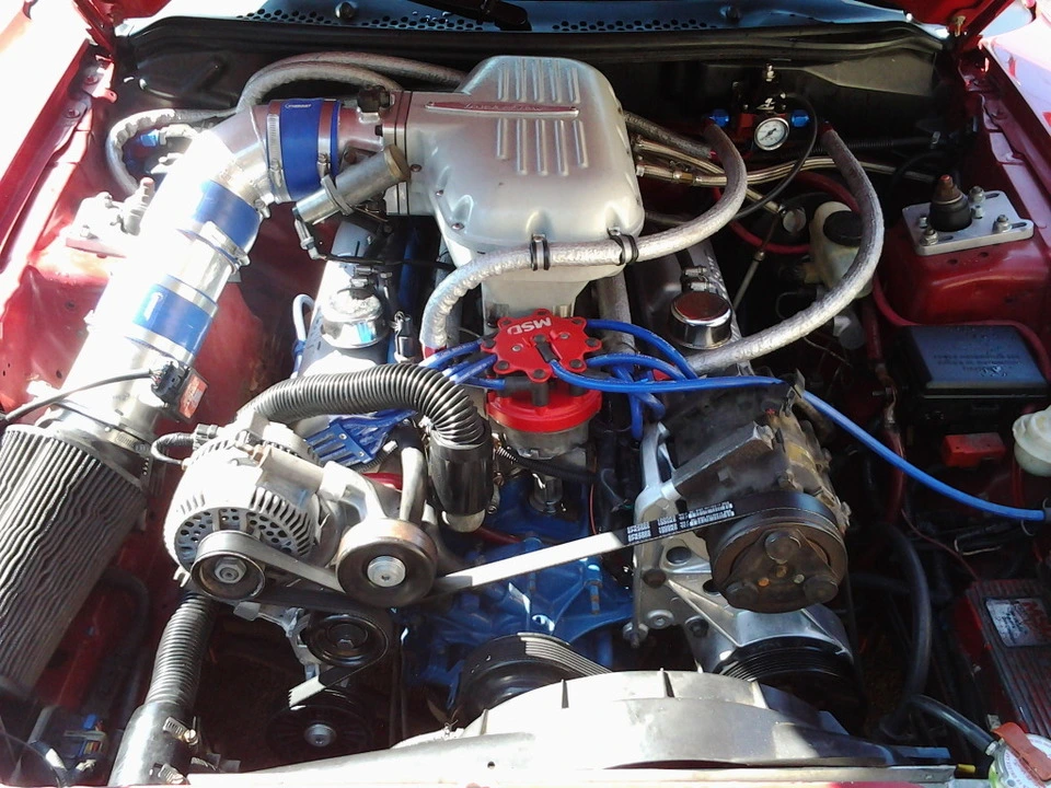

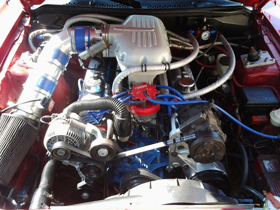

Heres my engine with the truck brackets. The alternator in it now is just a cheap 90amp one
